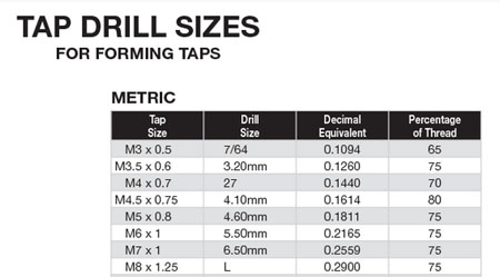

  4. Rick 2.0
    2,854
    1,525
    Actually, 4.2mm is for cut threads. For formed threads 4.6mm is recommended. And if I had one, I'd give it a try but as these screws don't have a pointed tip like a forming tap I really question if they will go into a 4.6mm hole.
  5. Joe Santarsiero
    Joe Santarsiero OB addict
    Oct 30, 2014
    902
    196
    Typo. That's the chart I was referencing. Your probably right in that the flat top won't be as happy in the .181 hole vs. The 3/16.
