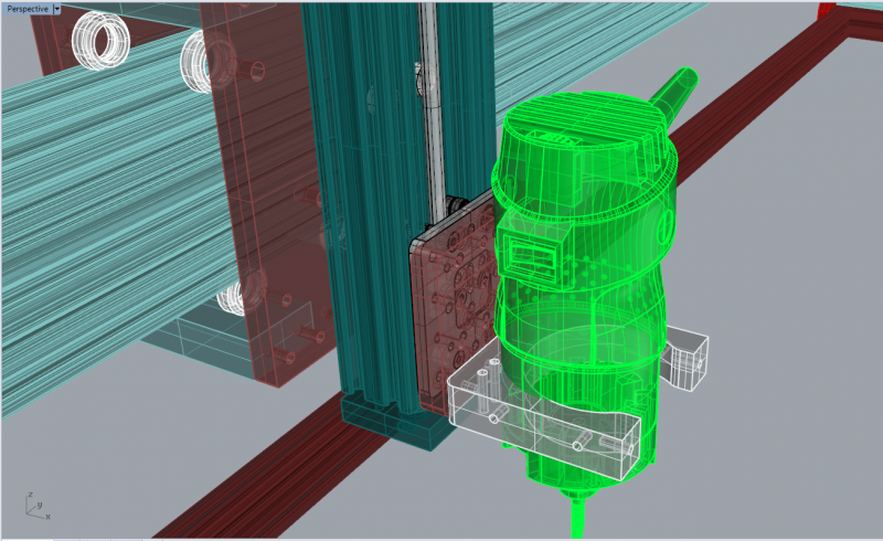

    Thought id post this idea i have rattling around since the cbeam came available for what i believe could be the strongest ox yet. I'm undecided about building another at the moment as i simply don't require another but thought id share the idea.
    The design is pretty rough but the fundamentals are there. Design below is 1500 x 1500 - cutting area something like 1250 x 1250
    Motor and belt need to be offset from center to avoid rubbing on the mini vwheel, the standard motor and idler wheels would work, just need to remove a corner to fit.
    You cant see very well in the images but all the axis motor mounting, belt and idlers are the same. Only on x the mounts pass through the y gantry plates.
    I haven't added any profiles to bridge between the ends of the y profiles as i believe with this design simply bolting to a solid bench into the feet from the underside with some care would work to the same effect

    I was planning on using the double belt with the short tension length close to the motor which would be mounted on the x and y plates. Several examples available on forums. http://openbuilds.com/attachments/image-jpg.7510/ is one example, but i would prefer a shorter length between drive - idler pulley - belt in v-slot.

    Yeah this is one thing I'm unsure of how well the pinion and idler performs set up like this, something I was hoping people with experience would comment on.
    What ever the solution, I thought it would be nice if the x and 2 y's were all identical in assembly.

    Working on the design with belts. Only using single C-Beam for the Y, double for the X. Was designing the plates so the steppers could be mounted inbetween "gates" of the C channel or underneath.
    Trying to reduce debris from belt and pinion. Not sure if an underneath mount would create a problem with belt "falling" out of the slot. But also concerned with increase friction of mounting an extra pair of wheels in the C channel. Plates would be 3/4" aluminum with a 1/4" cutout to allow the motors to have enough shaft for the proper pulley alignment.
    Thoughts?

    Looks good.. My only suggestion would be to shape your gantry plates so they are wider at the bottom to allow you to spread the v wheels further apart and improve rigidity.
    With the motor being used in this arrangement i would go for having the motor inside the c beam but add some mini vwheels to run on the bottom inside slot, That way you can run your belt underneath the wheels in that slot and loop over the pinion in the same manner as the original ox design.

    just spotted thats what you have done in which case go with that one. It will be better balanced than underneath.

    Thanks for the advice. The gantry plates are about as wide as I can make them (8") and still have the 48" travel on the Y-axis. The plates are approx. 8" x 17". If I made it wider, I would have 1 set of wheels hanging in the air at the extremes of travel. Hoping to start this build Oct 1. Of course I haven't even touched the Z gantry, but I like your original design with the extra mini wheels inside. Also trying to design the gantry plates with cable management in mind. Hope I provided enough cut outs and mounting points. :) Do you think I may be introducing too much torque by having the X-axis that high?

    Thanks for all the pointers. Made some revisions, and feel pretty good about the current design. At least until I get some more feedback ;)

    Any reason for the slanted gantry end plates? Seems like you would have some issues with the wheels loads being quite different depending on what direction the router was moving.

    yes you may have an issue with the slant.. you could just move the slant to start above the wheels. that may work. what i did on my ox which made a big difference is have another plate on the inside of the plates, square hole through so the x profiles go through it at the top and a block just above the wheels to space it parallel, and going down to the top row of vwheels with the vweel bolts going through both plates to stop any flex in the wheel bolts. seem to make things much more rigid.
    Originally the design was std plates either side of y profile square sloted through as above, but i decided i didnt want the y profiles floating so i cut the inside ones and that gave the arrangement im talking about. worked well. not very apathetically pleasing but thats where most people go wrong.. it doesnt matter what it looks like its how well it cuts and youll find people that try to make it look pretty end up making un asphetic modifications that if they were designed for originally would have looked better anyway.
    instead of a full plate this could just be a block on the inside of the plates with another plate bolted to that hangs over the ends of the vwheel bolts, that would most likely look neater in some nice polished ali.
    But other than that the h beam and x carriage look good,

    Thanks for the critique. I was trying to move the router back to provide better table management. No reason i can't redraw with the slant above the y-axis.
    Trying to visualize the double plate. I understand the top part where they join. But where I having a problem (comprehending) is underneath the y-axis. Are you running bolts completely under the Y to join both plates also? Or are you just running the top wheel bolts through both plates? I had wanted to support the Y on the base at several points along the axis. If you have a chance to upload photos, I definitely would appreciate it.

    Your center of gravity is key here. Getting the COG right will reduce the torque on the outer wheels of the gantry and make acceleration and cutting stability closer to balanced in both directions.
    Slanting the plates wasn't a bad idea because you had shifting the COG in mind (and possibily extending the holding area). However, the point at which you would want to drive the gantry has now been offset. The slanted plates give you limited room towards the front of the slant for drive systems. Also, you have reduced the amount of overall travel because your top and bottom wheels are out of alignment. IF, you redesigned with the wheels aligned you would essentially correct this problem.
    Personally, I'd stick with the vertical plate and offset gantry beam just like Marks original design. This will allow you to maintain a better COG and give you room on the center of the plates for your drive system. You could always screw around with exotic plates later on with a machine that we know will make them.

    Hmmm, I'd say the original plates cog was front heavy anyway. It would be hard to measure but suppose you could try assembling the x + z + gantries and use fishing scales hooked on front and back or balance on a rod to see which way it goes.
    If it falls back just add some more Ali to the z or vice versa.
    In regards to the bolts yes just secured anywhere heigher or at the x profile with corner brackets and at the bottom with the vwheel bolts. Or simply a block bolted to the inside with a plate that has holes for vwheel bolts.

    Thanks for all of the advice. Re-drew the y Plates. Shortened them considerable. Just over 10" total height. Haven't figured out a way to put 2 plates on each of the Y's. I'm limited by the 1500mm C-Beam. and if I double the plates, I will not have the 48" cut width. Any further suggestions much appreciated. M-Hox2.png M-Hox.png

    By the the double plates all that would be achieved by it is supporting the vwheel bolts on top row at both ends, so it wouldn't need to be a plate. It could be two 12mm thick bars one horizontally and one vertically bolted together to make a L shape say this - represents the wheels it would look like this L- rotate that 90 to the right and bolt to inside of gantry plate.
    This may be a little ocd, it something that would pretty easy to do as a later addition. Actually thinking of milling some blocks and selling with wheels installed in them. the arrangement made a big difrence for my ox as those bolts do flex left unsupported. It seemed to happen in mine over time like they suffered fatigue.

    The second plate doesn't have to be full height. Like Jonny's idea, which is only as high as needed to support the wheels, the plate too has to be only as high as needed to support the wheels.

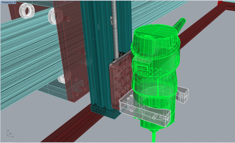

    Trying to finalize my plates. I have a question about the Z-axis.
    I was planning on having the C-Beam fixed to the X-carriage and having the router ride up and down on the smaller carriage of the C-Beam.
    Is there any advantage/disadvantage to doing it like this or reversing it and having the C-Beam fixed to the router mount?

    Mechanically I can't imagine it makes much difference except you'd be adding a bit of weight to the z with the cbeam the opposite way
    Suppose the upside to having the cbeam bolted to X gantry plate is you then have something to attach the cable carrier to.
    But then the otherway round would provide better chip protection for the lead screw.
    So you could say bolt the cbeam and use brushes to keep out chips or the other way with an additional Cable Carrier mount
