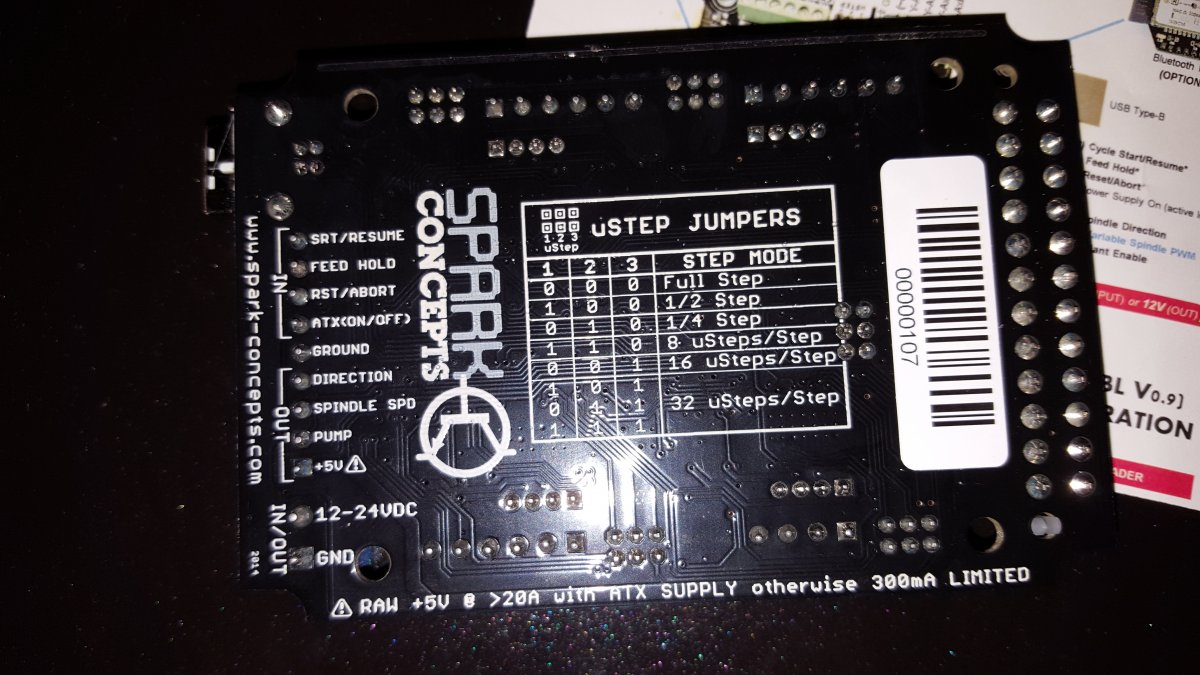

    could there be a problem with the jumper connections on the drivers?
    maybe they are inverted or just not connected correctly?
    I have Big Easy Drivers that default to 16x microsteps, but the 8825's default to single step unless you fit jumpers on the CNC Shield.
    Caught me out at first (-:
  12. Hybrid
    Hybrid New
    Jun 11, 2016
    Well, changing jumpers possition makes a change only on the travel length but not enabling microstepping. That sounds like there is something wrong with the controller.

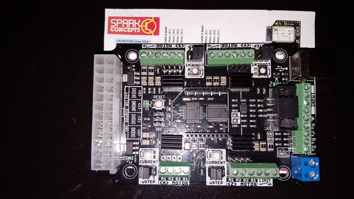

    This is the one I'm using:
    CNC xPRO Controller V2
    There is no way to mix up the jumpers.
    Will contact seller tomorrow for replacement.
