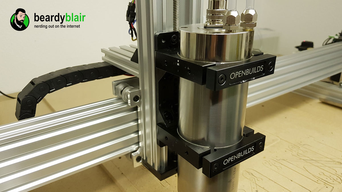

    So first thing was to mount the spindle, to be honest I thought this would be the hardest part of the process. It "turned" out to be the easiest!

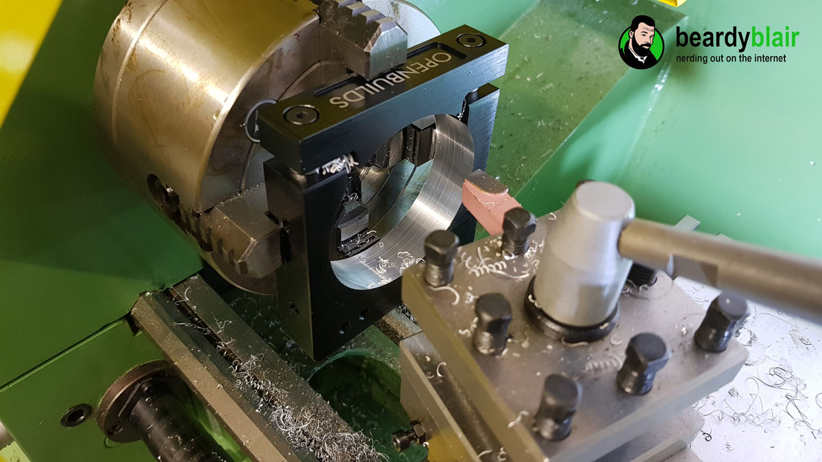

    I simply enlarged two Openbuilds 73mm holders to 80mm using my lathe. If you intend to do this use two 5mm spacers and clamp the front plate in place (also but something soft on the jaws!) and center it in a 4 jaw.
    This worked a treat and in my opinion is a better solution to the 3D printed versions people have done elsewhere.
    I mounted them to the backplate with 2 angle brackets per mount. I will possibly be adding another 2 to each bracket to stiffen it further depending on the back plate I end up using. There is no play here, the motors have no issue and I did not see any noticeable deflection. There is however still a twist on the Z axis when applying pressure on the X plane. I have a plate designed to fix this.

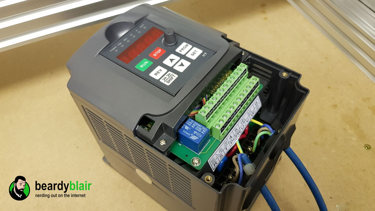

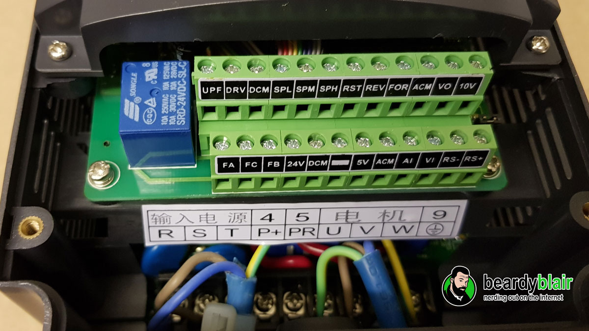

    Next up was to wire up the VFD. The instructions were written in english and fairly technical. If you are not electronically inclined its a tough read. As always, the internet was filled with many how-to's and provided me with all the help I needed. So here is what I took from it all and my instructions incase I need to reset or rebuild. Please note that I am in the UK and am using 240v single phase AC power and for now I will be controlling it from the VFD.
    Remove the lower plate on the front of the VFD unit. Connect power cable to the lower terminal bar. Positive to R, negative to S and earth(ground) to E. I used 13A rated flex. Do not connect the spindle wiring yet.
    Program the VFD for your spindle (note: my settings are shown).
    To enter the programming mode press "PRGM", you will then see a parameter entry eg PD001. To move between or select a parameter use the up and down keys to change the value
    of the digit, the shift key to move to the next digit and then SET to select and go "into" a parameter. Its current value will then be shown. Use the same method to change and set its value.
    First thing, reset the settings. Very important, mine was not "factory" or correct for the spindle. To do this change parameter PD013 to 8 and then press SET. Your VFD is now reset.
    Next adjust the following parameters to match your spindle, you can use the manual and set up "everything".
    PD001 0 (0 as I am using the front control knob for now)
    PD002 1 (Set to 1 as I am using the control knob for now)
    PD003 400 (Main frequency - set this to your spindle frequency)
    PD004 400 (Base frequency - set this to your spindle frequency)
    PD005 400 (Max frequency - set this to your spindle frequency)
    PD006 400 (Intermediate frequency - set this to your spindle frequency)
    PD007 0.50 (Min frequency)
    PD008 220 (Max spindle voltage - not input voltage)
    PD009 13 (Middle spindle voltage)
    PD010 6.5 (Low spindle voltage)
    PD072 400 (High-end analogue frequency - your spindle frequency)
    PD072 120 (Low-end analogue frequency - your spindle frequency)
    PD141 220 (Rated motor voltage)
    PD142 10 (Rated motor amps)
    PD143 4 (Number of motor poles)
    PD144 3000 (RPM at 50Hz. Since the max RPM is 24000 at 400Hz, this means that the RPM at 50Hz will be 3000)

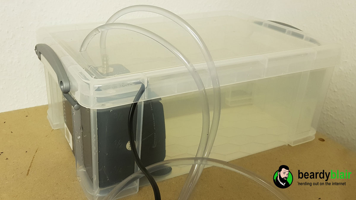

    With the spindle mounted and VFD programmed I set up a temporary cooling loop. I used the supplied submersible pump set in a storage box and some 5mm clear tube I had a reel of. I intend to build a larger dedicated system for use ith a few of our machines with heat exchanger that will dump the heat into the communal part of our offices where it is always cold.

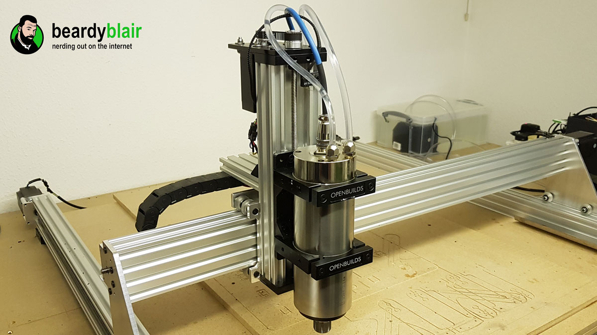

    And here it is all assembled and ready for use. Lots of cutting to be done on Monday so will report back then.

    Awesome! That spindle looks to be no bigger than my 800w. 65mm?
  28. beardyblair
    beardyblair Well-Known
    Aug 1, 2016
    59
    72
    Its a 80mm spindle. Although I have taken a bit off the OB clamps there is no movement and I am really happy with the results. Will be testing on alloy this week.
