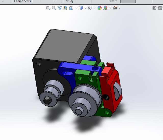

    Keith,
    Great design, can't wait to see it working.
    Thanks for the props...that's what this site is all about, sharing and learning from each other. Every build on this site makes you think, rethink and wonder a bit...all good stuff :)
    I'm very curious to see how well the DDE (direct drive extruder) works...it might change my mind as well ;-) What size motor will you run on it...17 or 14? I worry about a 17 being too heavy for my setup!?!?
    Brook over at Printrbot comped me a couple sets of their Gears Drive Extruder gears so I could play around with Nema-14 design. I've got one modeled but wonder if the 14 is going to have enough power to push the filament!?!? The 14 I have now run a 2 to 1 reduction so it works fine.
    I certainly don't mind running a Bowden extruder but DDE'd are so much easier to change filament ;-)
    Have fun and keep us posted...

    Keith,
    This little extruder is working great with the current gearing ~2 to 1 (I've have to check the tooth count to know for sure), although it did get pretty hot at first. After a current adjustments the overheating has not been a problem. Even though it works well I think going with a bit taller gearing would only help. Make sure you can find the length belt you need/want first though, that could change your design in the long run.
    This SITE works great to figure out which belt might work best.
    I used this ONE and had to buy qty (10) if there is any chance it will work on your design let me know and I'll send you a few.
    That's another thing to consider, even though you might find a good length belt, they may or may not be readily available!?!?
    I think my design can be easily adapted to a DDE as well as the larger main gear. It is one of, if not he smallest generic geared extruder out there...at least that I can find ;-)
    If you'd like my Solidworks files or a Step files just let me know, I'd be happy to share them!!
    Sonny

    Keith,
    I must admit, I do like that little pancake motor...might have to give one a try, as well as whet ever extruder you come up with ;)
    I used these STEPPERS all around, basically 18Ncm(25.5oz.in) at 190 gms, so although it as a larger profile it is 25% lighter which might be a worth while trade off!?!?
    Glad you liked the calculator...although that old-school method will still work in a pinch :cool:

    David,
    I currently run that same extruder on my FT Full Sized Printer, it's not as Itty Bitty as you might think...
    Here's my extruder side by side with the Itty Bitty, as you can see, mine is much smaller. I do however really like the extruder on my full sized printer, it works great, and with a few mods it allowed me to use a smaller drive gear and smaller bearings I had laying around.
    It's a great design, and again, it works great, it's just a bit big for my small Canti printer ;)

    Sonny, David
    I should get that pancake Nema 17 (20mm) tomorrow (Thanks David). By the 25th I should have a 50T 2GT pulley and 126mm belt to run against a 16T for a 1/3.125 ratio (Thanks Sonny for the calculator link). This should cost $6.80 for pulleys, belt, and bearings more that my regular extruder.
    Here's how I'm going to try to use them. Pretty unorthodox! One thing about mounting the drive mechanism on the back of the motor - the screws on the back go all the way through the motor and screw into the front flange to meet the front screws, so there may be some need to micro adjust the depth. This has room for using an E3D with the standard pipe fitting keeper (the brassy looking part) for running 4mm PTFE all the way from the MK8 drive gear to the E3D barrel. I don't think I'll need a guide going into the drive gear, but it's trivial to adapt the pillow block there if needed. The two red bearings supporting the drive shaft from the 50T pulley to the MK8 are 5x11x4 or maybe 5x10x4 from the mini-v-wheel kits. While I'm waiting for the 50T pulley and belt I'm going to remove the nozzle, print a pulley, and use a thick rubber band just for testing.
    [​IMG] [​IMG] [​IMG]
    Back to the Simplrbot. This extruder will be perfect for it if it works as envisioned. But, I realized that I can add a bit of extrusion and use cheaper wheels and use the same basic layout to build an adaptation of my OneZ 13 that will be $120 cheaper to build, is 3 inches narrower that my i3, and only $3 more than the Simplrbot. So..... when I get this light extruder assembled later this month I'll go ahead and finish up the Simplrbot, but I'm concentrating on a OneZ i4 in the meantime.

    Keith,
    Looks and sounds like a solid plan, I look for to seeing the results!!!
    As far as being unorthodox, my bet is most of truly innovative designs started off that way...it's **** sure got me thinking...

  28. Keith Davis
    Keith Davis Master
    Dec 11, 2013
    315
    178
    I ceased working on this Anthony.
    Using a direct drive 40mm extruder was OK, but there was vibration artifacts in the print from front to back. What was happening - on non-print moves the X axis vibrated the direction of that move and continued when extrusion resumed. The cause was using a printed plate for the X-Z wheels. Using a metal plate would correct it but add cost to the unit, something I was not willing to do. Because established retail price range for a cantilever printer is low, that added expense was a deal breaker. I don't design for amusement or personal use but for marketing.
    The mini belt driven extruder also had the same problem. But I was disappointed with that mini extruder, it weighed in only 4 oz less that the full sized extruder, for double the cost and complexity.
