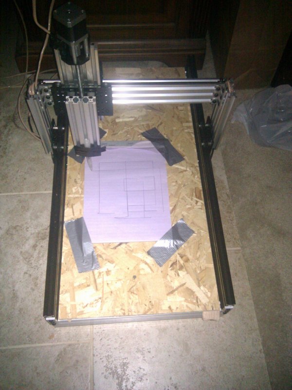

    FYI the z-travel on this beast is 90mm
    #165 The Dude, Jan 27, 2014
    Mark Carew and Chris Allen like this.

    Yeah the main thing is the weight of the z-axis assembly+spindle. My assembly is extremely heavy when you add up all the screws, gantry plates, washers, v-slot, 2 motors, brackets, leadscrew, bearings, etc. Thank goodness the spindle I'm building is only 420g.
    I've also noticed there is a slight wobble if you don't do it right. Meaning, get the gantry square and the sides fixed at multiple points.

    Doood, it works good enough to draw. :)
    Chris Allen likes this.

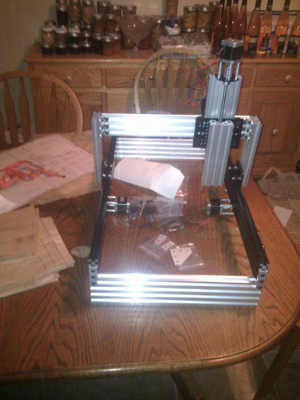

    Think my frame is finished. I might need to do a better job with the z-axis leadscrew, but i'll see how it goes. My driver board and power supply should be in on Friday so i can hook up all the stepper motors!

    Hey man it works. Got the spindle going and all 3 axes :)
    It's kinda slow cause I have it all turned down for safety until I get the limit switches on. I tested it at 200mm/s and it does fine.
