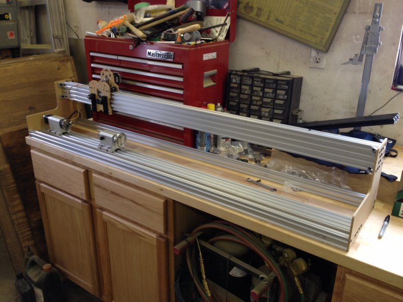

    My build is progressing. I had a few minor tuning challenges with my OX CNC which made the cutting of the sample plates a bit time consuming but now have a set of plates made to build up the prototype RotoOx. I have the X-Axis installed and the beam for the A-Axis but hit a small snag when I went to install the 20x40 stiffening rails. While the 20x80 rails are exactly 1500mm long, the three 20x40 rails vary in length by between 5-8mm oversized. Fortunately, the rail that is 8mm too long has a tap broken off in the end of it and hopefully I'll be able to extract it during the trimming process.
    My plans were to use 6.0mm hardboard for prototyping purposes so I was not wasting expensive 1/4" aluminum plate figuring things out. I figured the hardboard would work for layout but would not be up to supporting a running machine. Although I am not yet done assembling the machine, I am surprised how stiff it is becoming even being build out of inexpensive compressed sawdust. I doubt the hardboard will stand up to much abuse but at least I should be able to make the machine run a bit before upgrading to aluminum plates.
    I'll snap some pictures once I get the 20x40 rails installed you can see how it is coming together.

    Most of the mechanical assembly of the Roto-OX is complete with the exception of the Z-Axis due to some parts on backorder. I am pleasantly surprised at how stiff the machine is lengthwise even with the hardboard ends. The stepper motor for the X-Axis has some play in it so will not likely stand up to much use as is but should be solid enough to at least make a few test cuts. I will update as the build progresses. Roto-OX Under Construction.JPG

    It's Alive!!! Well sort of, at least.
    I did a quick and dirty installation of my new TinyG controller board yesterday and have the X-Axis working well (Mainly because I was able to re-use the tuning numbers for my OX CNC). The A-Axis will move but I have had to map it to the Y-Axis because TGFX doesn't have a jog control for the A-Axis. Still, I am able to make the X carriage move side to side and have the A-Axis spin a block of wood I have clamped in the chuck so I call that progress. There is not much information on the TinyG wiki about tuning a rotary axis so I am going to have to do some experimenting to get the A-Axis functioning as it should.
    Robert, I have adjusted the eccentrics to their minimum tension but still found the spacing around the X-Axis beams a bit tight. I can work with the tension as I have it for prototyping but would like to have some adjustment in the final version. The currently installed X/Z plates are v0.2 which included an additional 0.5mm of clearance and they are better than the v0.1 plates which fit but were way too tight. That is why I am leaning to use 1.0mm as the additional measurement from my original design to allow for some wheel tension adjustment. I think I am going to take some detailed measurements of what I physically have and modify my plates accordingly. There is no sense repeatedly tweaking the design based on guesses when I have a built assembly to measure.
    I am using 20X60 for the Z-Axis. In the picture above, if you look behind the machine you can see a piece of black 20x60 which will be used for the Z rail. I had forgotten to order 45mm bolts for the Z-Axis when I ordered the parts for this build so I cannot mount the Z-Axis wheels till my next parts order arrives. Also , the Openbuilds store is out of ACME threaded rod so I can't install the Z rail even if I did have the wheels. Supposedly more ACME rod will be arriving soon so hopefully I'll be able to finish the build up and give the machine a try.
