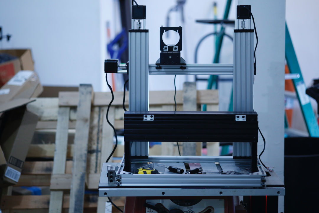

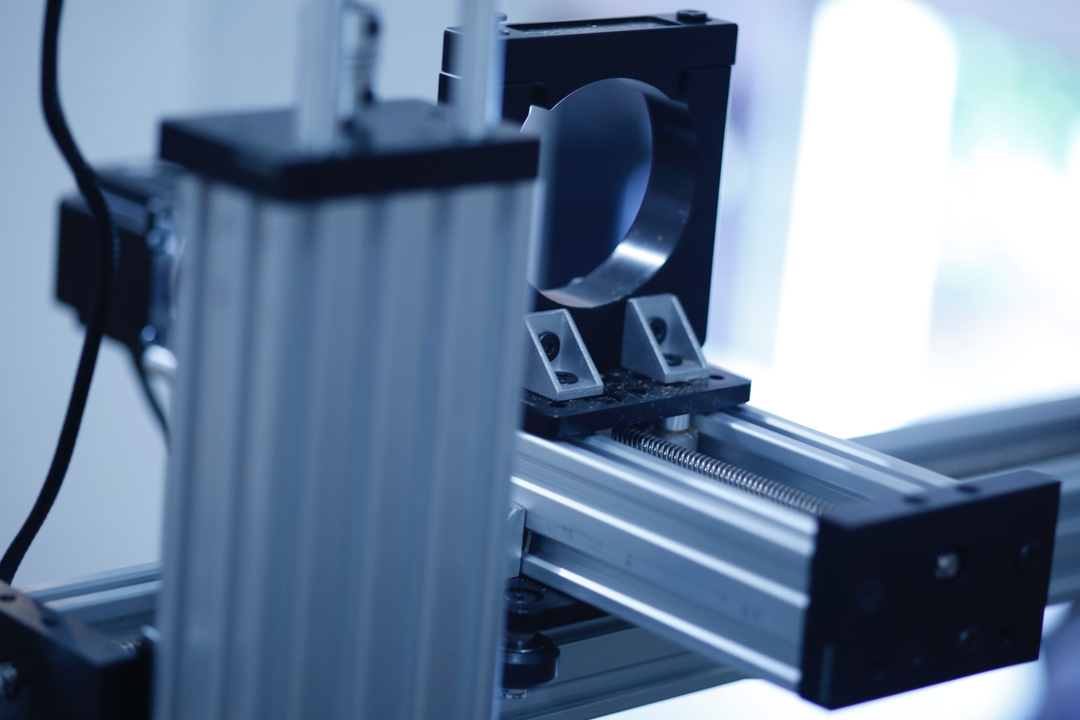

    JimB828 published a new build:
    Read more about this build...

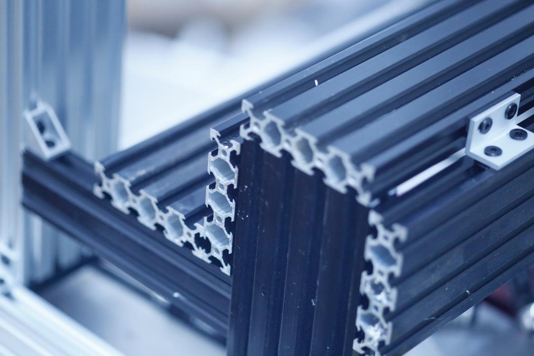

    [EDIT: I'm moving some of my update information from the build page to here, so that I can update the build page with more detail on the actual build, instead of my updates.]
    Update #1: 2017/07/15
    The concept works, and I'm getting somewhat accurate cuts in test pieces. However, the cuts aren't accurate enough for use. Part of the problem, because this machine does not have a lot of rigidity, is getting everything truly square. Also, because the router sits horizontally, weight is pulling the bit to a slight vertical angle. In order to combat this, I am in the process of trying to turn the vertical C-Beams around so that the moving gantry will be on the backend of the machine.

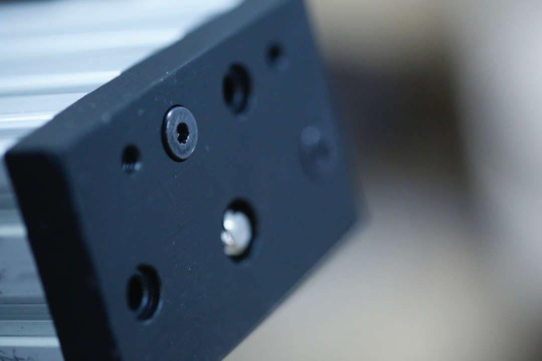

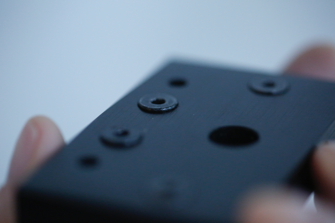

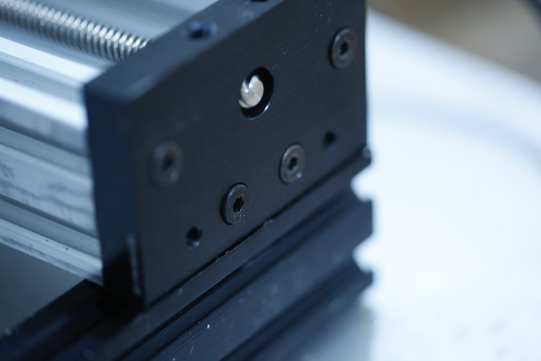

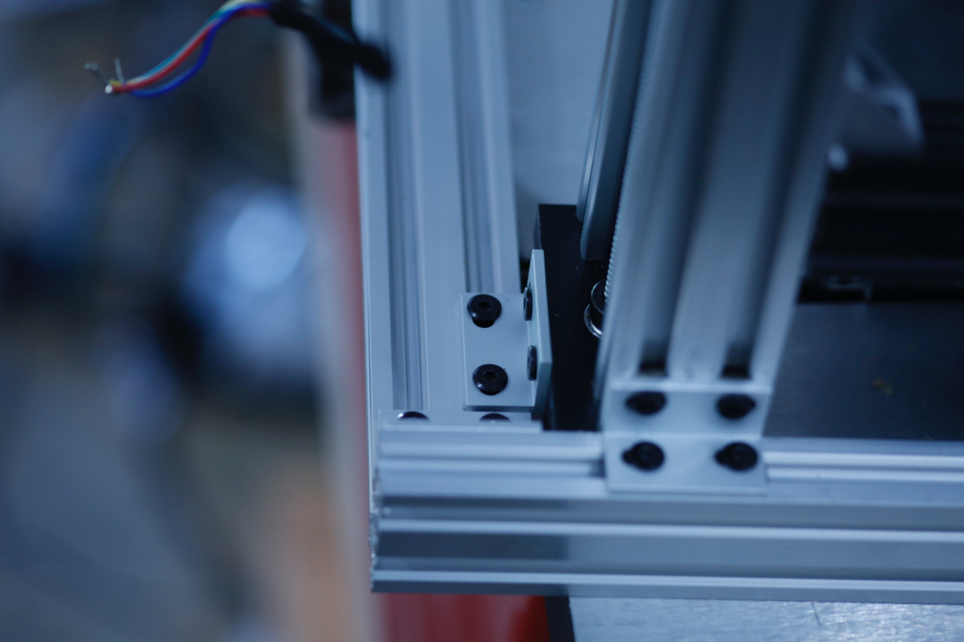

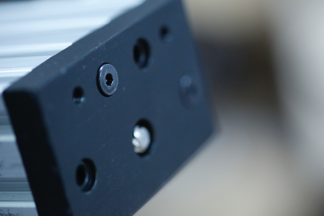

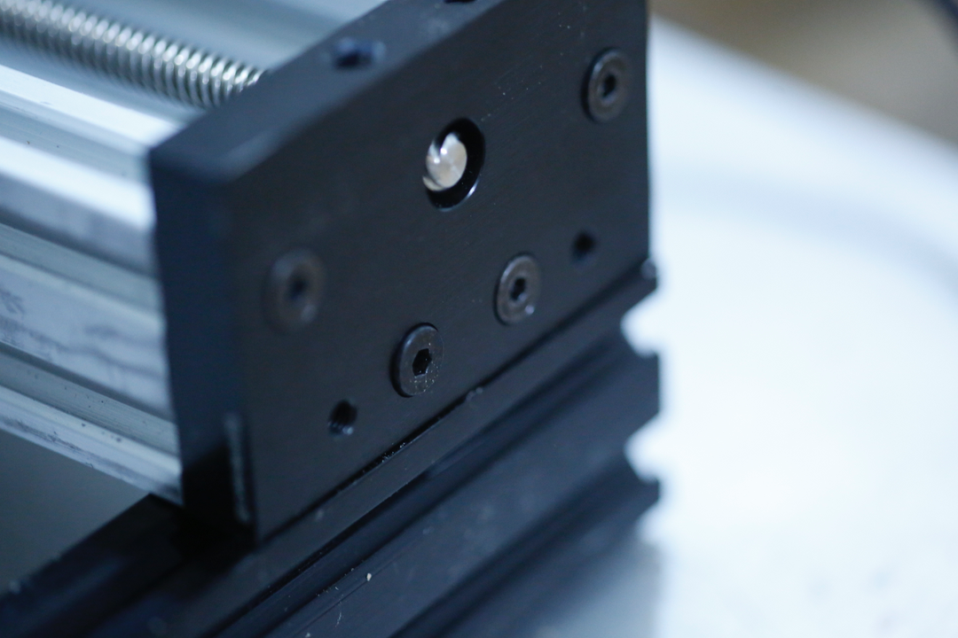

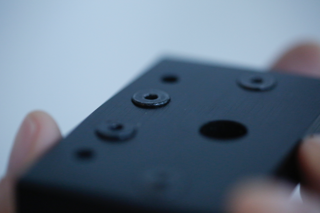

    This effort has uncovered another problem: the counterbores in the C-Beam end mounts are not only NOT flush with the end mount, each one has a slightly different depth. This is causing the two vertical C-Beams to not sit flat, and is making it very difficult for me to get each to be perfectly aligned. I've re-tapped the holes in the C-Beam--thinking that the taps were not deep enough, which was true in a couple of cases. However, holding the end caps in my hand and sitting the screws in the cap shows that it is the counterbores.
    View attachment 25562 View attachment 25563 View attachment 25564

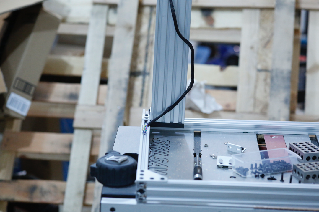

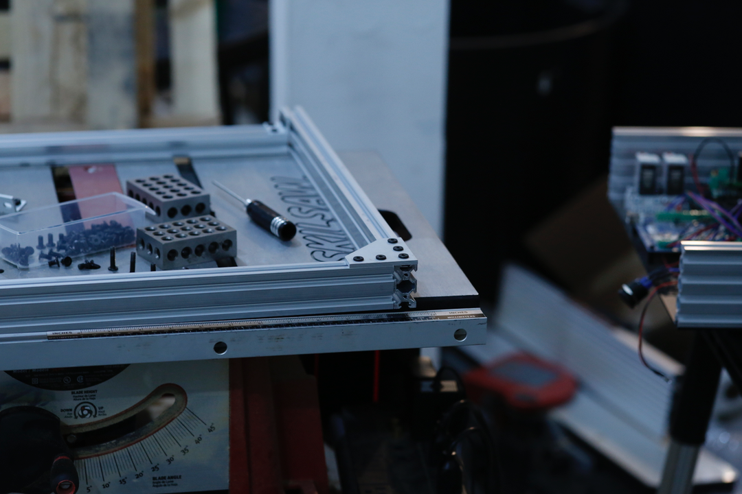

    Update #2: 2017/07/16

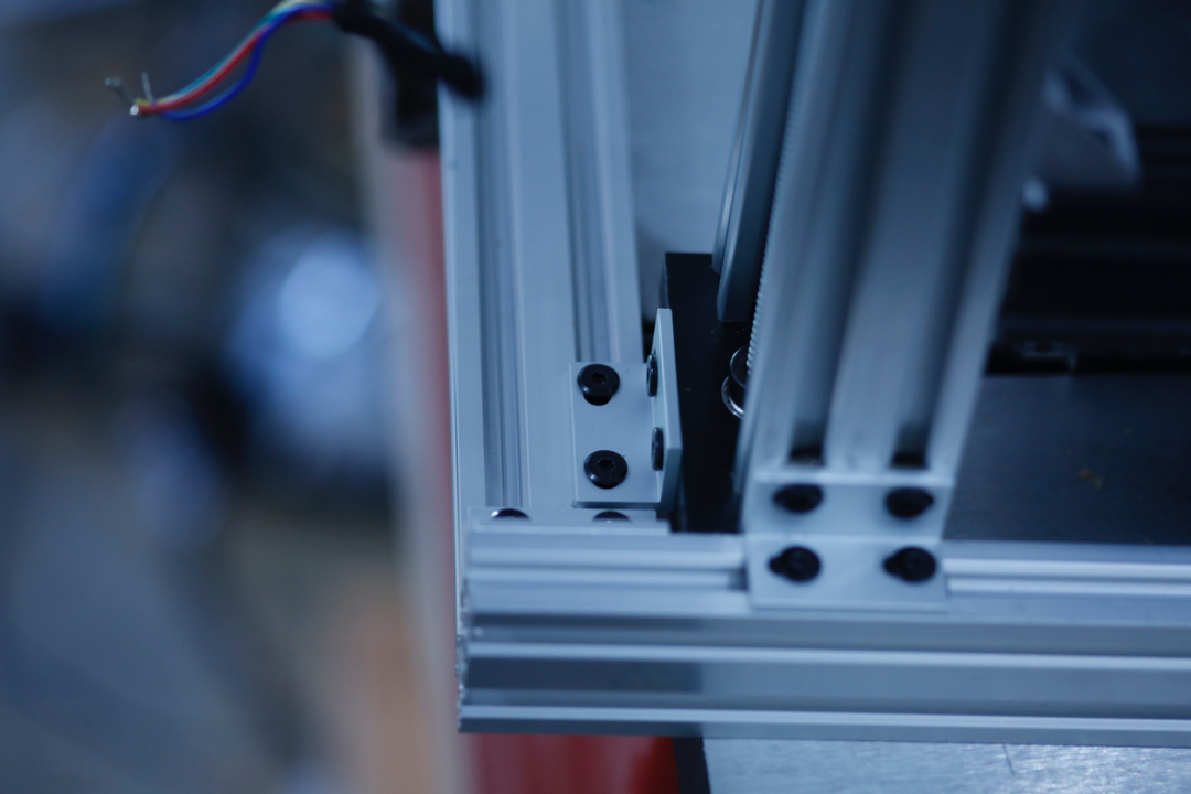

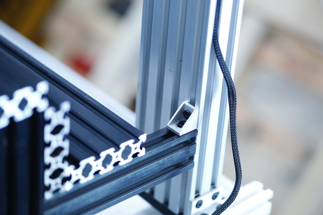

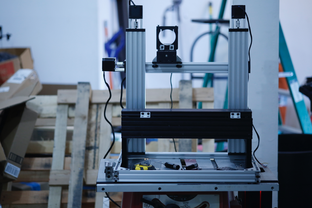

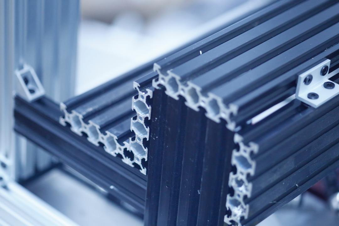

    Because of the issue that I was having with the counterbore depth in the C-Beam end mounts, I had to find a way to raise the end mount off of the table surface. I had a piece of 20x40 which I laid flat on the table on the 40mm side. I also created a bottom frame using 3 more pieces of 20x40 (each approximately 500mm in length).

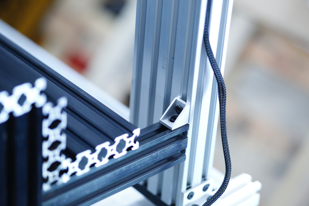

    Once the frame was square, I used a 2 hole angle bracket to screw into the 20x40 and the front screws on the end mount (that are supposed to be for the C-Beam shield).
    However, because there is no support on the back of the C-Beam, it was not staying true at a 90 degree angle from the surface of my table (the top of my table saw).
    I knew I needed to recreate the "table" on the machine to hold material for both the mortise and tenon functions; in other words, to be able to clamp material flat and on its side to the machine. I added supports to the front of this table to push back against the vertical C-Beam to keep them at a true 90 degree angle.
    View attachment 25614 View attachment 25611

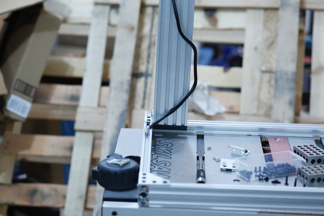

    The "table" has a front and a back, so that I can clamp pieces to the front for mortise work; using the back to clamp against. Of course, that makes it more difficult to clamp pieces for tenon work, so that's another problem I will have to solve.
    Checking everything again, the machine seems to be square, except the horizontal C-Beam supporting the router, which I need to fix; it is off just a hair from side-to-side.
    This is version 1.1 of the machine.
    View attachment 25613 View attachment 25609

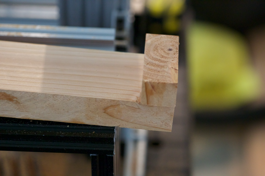

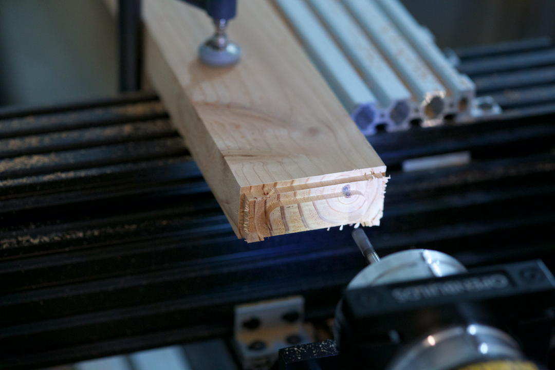

    Version 1.1 Testing

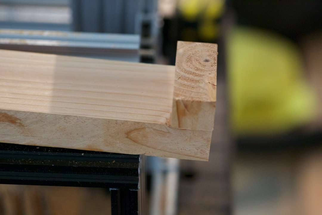

    Testing the tenon job that I've created works generally well. However, it's oversized by .5mm (X) in length and .25 in width (Y). I can't tell if the gcode I generated out of VCarve pro is faulty, if the Tinyg is off, if Chilipeppr is causing me problems (it always does; I can't wait to find an alternative), or if my config is off somehow.
    Using the Acme 8mm lead screw, I've got travel per revolution setup at 8mm; which I don't think is correct. But, changing that setting results in crashing the axes. I've got more work to do to figure out what's going on.
    Testing Update - SUCCESS
    The table that I built into the machine isn't size correctly for the mortise work. I mis-measured the movement of the spindle, so I had to start taking the table apart to move the frame around. I will have to continue to work on the best setup.
    The 8mm per revolution seems to be correct. It's possible that my calipers are seriously inaccurate. I was able to successfully mill both a mortise and tenon; although, I need to work on getting the alignment correct.
    View attachment 25624 View attachment 25623

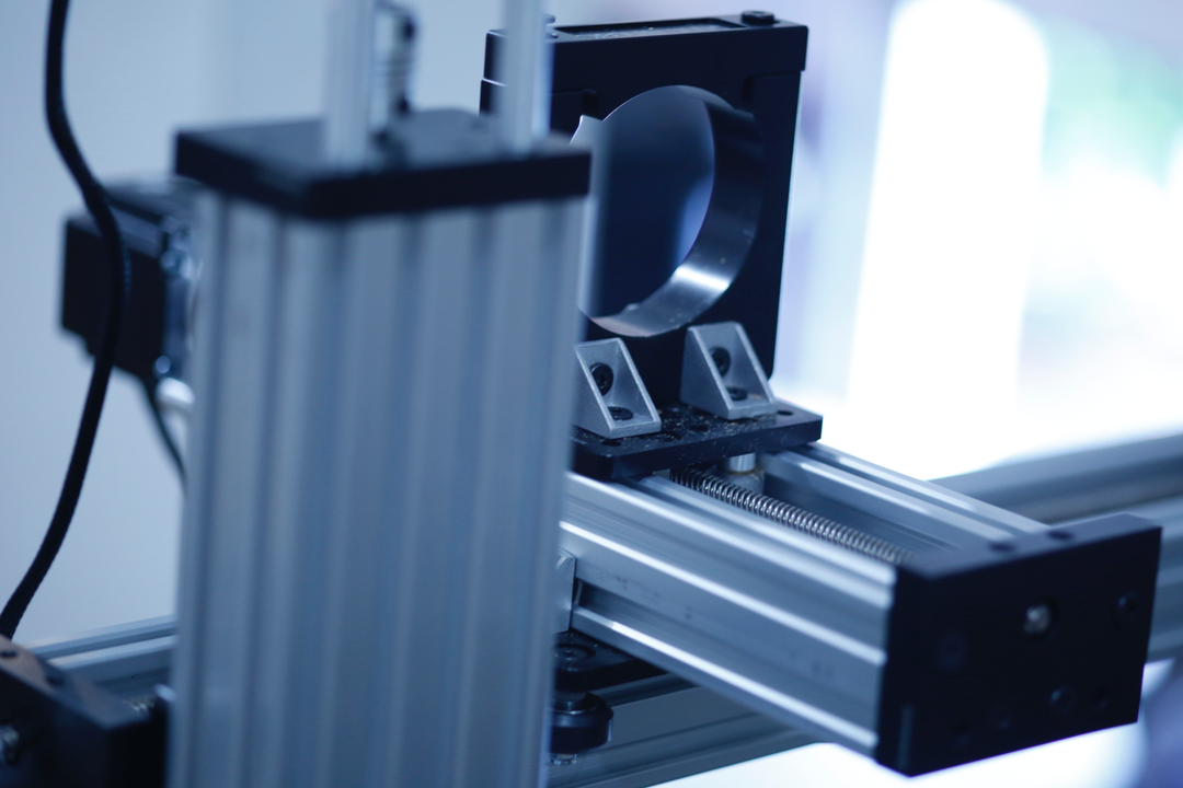

    I have also made some changes to the mounting of the gantry and the router, and added the C-beam cover to the Z-axis to decrease the amount of chips getting into the C-beam.
    I have had a little problem with the mini v-wheels loosening up inside the vertical C-beams. Unfortunately, because I originally used cast 90 degree brackets on the gantry plates, the only place to mount them was with the screws holding the wheels. I added spacers to each of the vertical C-beam gantry plates, and another gantry plate to mount the brackets.
    I'm going to add the C-beam shield to the other axes, but I need to change how the vertical axis is mounted to fit the shield there, and I need to change the way I am mounting the limit switch on the gantry axis for that shield to fit.

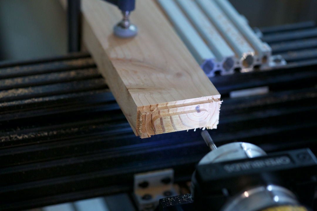

    In trying to test the tenon and mortise jobs, finding the edges, and accurately centering the cuts was a bit difficult using my triple edge finder. I purchased some aluminum duct tape, which makes it easy to find the edges on all four sides of the tenon piece.
    Finding each side of the part, makes setting the origin point to the middle of the piece easy. The tenon jobs cuts well.
    I'm also using the aluminum tape to find the edge of the mortise piece.
    I had either some backlash in the system, or I was missing steps, or both. The first mortise test I ran today started well, but quickly blew out.

    Yes, this is correct. I'm using the aluminum tape as a makeshift probe, since it wraps around the piece nicely.
    For the tenon, this is the process I am using so far:
    * Find the upper right X and Y, probing to each and using G92 to set them to zero. I do NOT correct for the diameter of the bit or the thickness of the tape.
    * Find the lower left X and Y. Since these are now offset from the zeros set in the previous step, for each, I divide by two and set G92 again (G92 X<posx/2> and G92 Y<posy/2>
    * Find the Z position and set it to the thickness of the tape (.005 for my tape) and set it using G92
    Now the zeros should be set directly in the middle of the piece.
    I am still trying to get an accurate mortise process. Since I am obviously miscalculating something, and ending up slight off on positioning. But this is the process I am using so far:
    * Find the upper right X and Y and set them to the opposite offsets from the tenon: X gets set to -<posy/2> and Y gets set to -<posx/2>
    * Find the Z position and set it to the thickness of the tape (.005)

    Because I wasn't using the table as a reference, I needed a way to probe to the underside of the board. My edge finder wasn't working well, since I had to hold it in place, and it was easy to let slip. Now that I realize my mistake, the edge finder still isn't ideal, because it's not a consistent offset in both directions.
    The 1-2-3 block is incredibly accurate, and I can use it in any orientation. I already had 3 pairs, so using one for this purpose is easy, and I can remove the bolt to use the block elsewhere.
