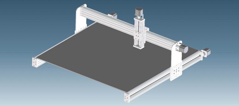

    How are you connecting the y-axis uprights at the rails? Can you you add an image of the area, close up?
  4. Skoobs
    Skoobs Well-Known
    Sep 9, 2015
    I was just going to bolt through the Gantry Plate into a T-Nut inside of the upright extrusion.
    Now I am wondering if there will be enough clearance for the head of the bolt, or if I will have to countersink the holes and use bolts that will sit flush with the surface.

    That's what I thought ...the clearances required for the hardware will require some mods to holes, tapping or counter sink or bore.
    Thanks for the fast answer!

    Also, the holes in the riser plates are tapped, so I may just skip them.
    Though I really wanted to make my own cover plates for the X axes. Would be bad to machine your own handle into them and mount them down the sides. *heavy breathing*
    but ultimately its not necessary, and would be purely cosmetic. probably more effort than it is worth.

    The other issue I see with using the internal rails in the y-axis, because the wheel support distance is very close together and with the x-axis so high, the torque on that area will be substantial. The unit I'm designing will use the external rails with a home made gantry plate with a rather far apart spread of the v-wheels. I will use the internal and external rails for a very stiff ride..hehehehehe

    I could make the cross member axis lower (you are referring to it as X, I was calling that Y, same difference) in order to drastically reduce the torque on the long axes.
    150mm veritical members rather than 250mm may suffice. I worry about the stability of plates. I am not sure if they would flex or bend.
    One of the other worries I have is the horizontal X axis holding the spindle. I wonder if it would put too much torque on the wheels. Your orientation seems nice, but once again requires a custom mounting bracket which I don't have the ability to make right now.

    You could easily make the parts so they wont bend. Currently pictured on my Sea-Ox I am using .25" MDF. That is certainly not strong enough for plates. But soon I will be having all of my plates cut from a piece of 2' x 2' x 3/16" Stainless Steel. The Stainless is extremely strong and will not bend.

    That would be ideal, but I was hoping to do this cheaper. Then, once I have this thing running, I can machine my own plates out of aluminum. I doubt this thing would do stainless even with the 1.5kW water cooled spindle.
    I guess I could see if someone at work would machine the plates for me if I provide them with the files. The downside to being at a big company is you cant just hop on a machine whenever you have downtime. resources are constantly being stretched to their limits.
