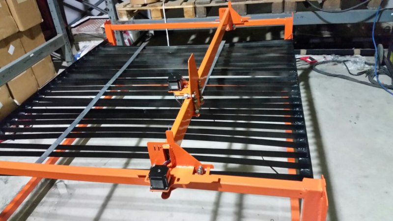

    Hi,
    I built one! I finished the steel frame after getting the laser parts. The design had to be converted a little:) In Germany you don't get the 76x25 Steel tube for the X-rail. I ended up buying a 45x25 and a 35x25 which is available. The carriage works as well on a 80x25 rail. The carriages for Y-axis are missing one slot for the weldin nose of the long Motorplates. I cut those two noses of. And I had to open up the cut out for the 80x25 X-rail.
    If I finish it and have a running machine I'll post a video:)

  5. Peter Van Der Walt
    14,037
    4,122
    Amazingly awesome! You just made my weekend! Cant wait to see the final result of your german engineering, improving on my sadly never completed project :)

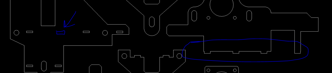

    Hello
    Noticed a dxf missing joint?
  7. Peter Van Der Walt
    14,037
    4,122
    Good catch!
    Its been so long, i dont recall, perhaps it was on my cut parts too, since those are more for alignment you could just grind off the extra tab, or fix the drawings before you send them in

  13. Squirrel101
    Apr 25, 2020
    Hi Peter, super design you have here. I'm also in ZA and want to attempt this design of yours. I have fixed the dxf file with the missing tab slots. Are there any suggestions or improvements on this design? Can you advise of local suppliers for these motors etc?
