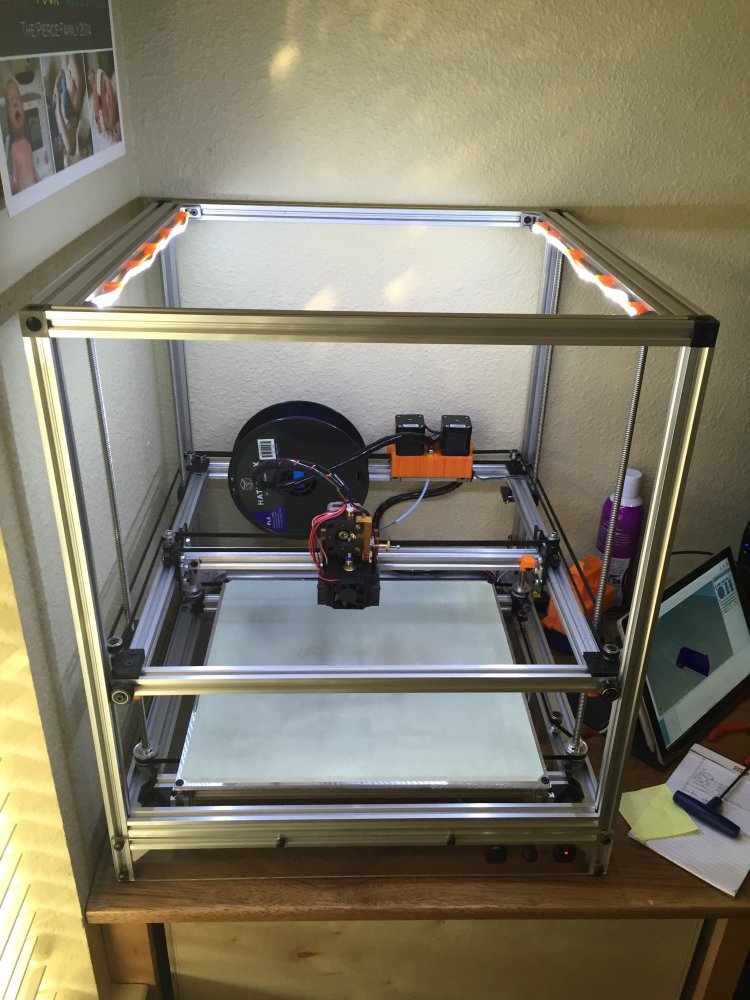

    Keith Davis published a new build:

    You could extend the back frame/compartment a bit and throw your electronics/filament etc. in there as well. Very nice clean design!

    Thanks Lucas.
    Another 50mm deep and I can fit the PSU, controller and a spool back there with the bowden driver above the spool. But, another 70mm and I can fit a second spool, second bowden driver, and use a Chimera hot end for dual extrusion. I think I'll probably produce it the 70mm deeper so I can convert from single to dual extrusion on the same unit.
    A nice thing about this overall fixed bed design is the bed can sit only 10mm off the bottom, reducing overall height. Which also eliminates room for putting the PSU and controller below the bed as is common on X axis bed designs.

    This is a really nice design. You can probably make the Z axis less likely to skip by putting an idler between the threaded rods. See picture below with and without the table.

    I've done a bit more design work on this that incorporates points you and Lukas have made.
    This type of design (fixed bed) is rather expensive to build so I'm thinking that the only way to commercialize it would be to add acrylic panels to make it a full boxed design. That would be purely cosmetic because the OpenBuilds wheels makes it already far quieter than a fully boxed design like Ultimaker. I'm still trying to talk myself into building it, or any fixed bed with a coreXY, due to the expense.

    I did implement your design in Fusion 360. Designed some custom plates for connections and steppers etc.
    You can have a look from here. Hope you like it and maybe it gives you few ideas (Please note I have never designed nor used a 3D printer till now)
    I might build this one when I have enough funds for it.

    WOW!!! A good idea put in the right hands becomes really GREAT Gino!
    I love the changes you've made - particularly the X axis carriage/extruder. And the double-back positioning of the two rear idlers for the Z belt.
    I'm assuming a controller board box opposite the PSU on the back wall, and also maybe converting the front panel into a door.
    Downloading the SKP file now........

    I built the XY carriage (no box & Z) to explore different ways to mount wheels. The design works with ordinary X & Y firmware settings, which reduces the constant calculation required for CoreXY and a real reduction in controller board temperatures. I use 2 F605zz bearings to create idlers which keeps idler cost down around $1 per idler pair.I never built the box to follow thru (got distracted). I got the idea from a drawing published by the legendary RichRap (Richard Horne) who I think built a XY carriage also. It was originally used in a Rikadenki brand Pen Plotter Old-school Scientific Pen Plotter Teardown
