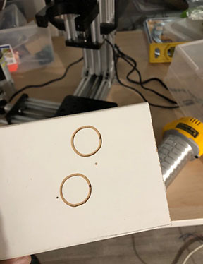

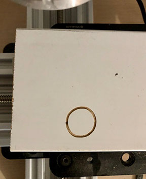

  15. alvingm
    alvingm New
    Sep 8, 2016
    I just finished building my OB MiniMill as well. I just ordered a Gradius M1 Pro with the Bigfoot drivers but for the time being, I have an SBase v1.3 lying around to at least test/calibrate. Doing basic calibration and try to do a circle it actually looks crooked. I reassembled my X (at least from what it looks a problem with the X axis) but still getting the same shape circle. Any pointers on where to look for next?
    thanks!
  16. Peter Van Der Walt
    13,751
    4,070
    wiggle moving bits by hand, feel for "looseness".
    Include wiggling your router by holding it by the endmill (router unplugged of course - not running hehe) as your play could come from either the XY table, or from the Z (router mount, z plate, etc) or from the frame (Z attached to XY properly)

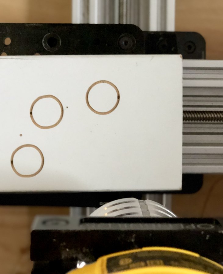

  17. alvingm
    alvingm New
    Sep 8, 2016
    thanks Peter. I think I solved it but not 100%. I can wiggle the connection between x and y just a tad bit, tightened that and it looks like it worked (at least more circle-ly than the other 2 ☺️)
    Probably need to start building my enclosure and permanently screw this on a platform.
  18. Peter Van Der Walt
    13,751
    4,070
    closer, but could still be better (;
    something is still not properly tight as it should be (;
    check my last circles on a MiniMill at the 1min58 mark onward in the video below - thats how round they should be (;
  19. Peter Van Der Walt
    13,751
    4,070
    Speaking of, how do you hold your stock down? Its not that the stock is shifting on you?
  20. alvingm
    alvingm New
    Sep 8, 2016
    I just screwed it temporarily on a piece of plywood. As far as I know, it's not shifting. Might need to double check the wheels on both x and y. My question about the wheels, right now, I think I maxed out my eccentric nuts (no more space to tighten them up). My wheels are not moving when I try to roll them manually with my fingers but the carriage is moving when using the knobs. When I'm building the carriages, I know I can slide them just fine prior to installing the motors
    #110 alvingm, Oct 5, 2017
  21. Rick 2.0
    2,855
    1,525
    You might check to see that the screws holding the anti-backlash nuts are tight and that the lock collars on the lead screws are snug tight against both ends inside the C-Beams.
