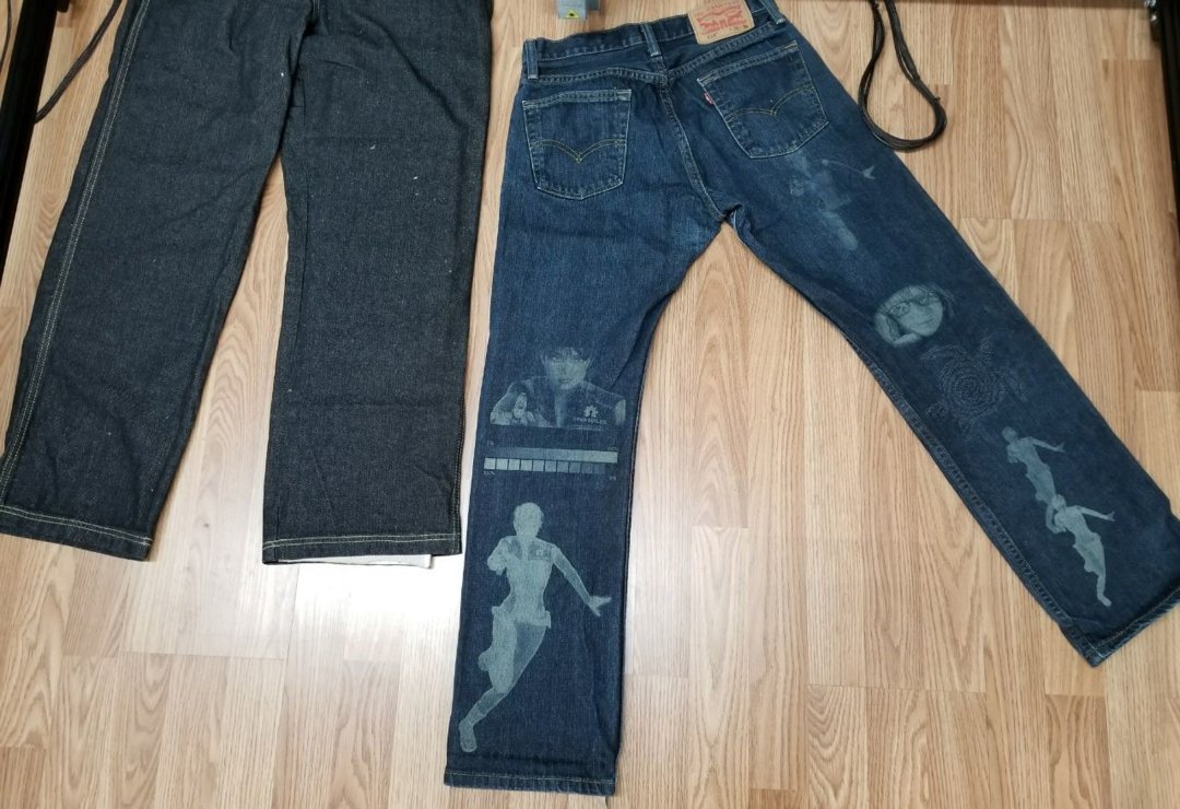

    We have been experimenting with using a laser diode on the ACRO system adding pictures to denim (jeans) and really loving the results! I just imagine all the cool custom jeans that could be made this way, fun stuff:thumbsup:
    More up close pics have been added to the bottom of the build page, check them out . When we get the proper settings we will share them out as well.

    Mark those images on the jeans look amazing, what brand are those, Michelangelo??
