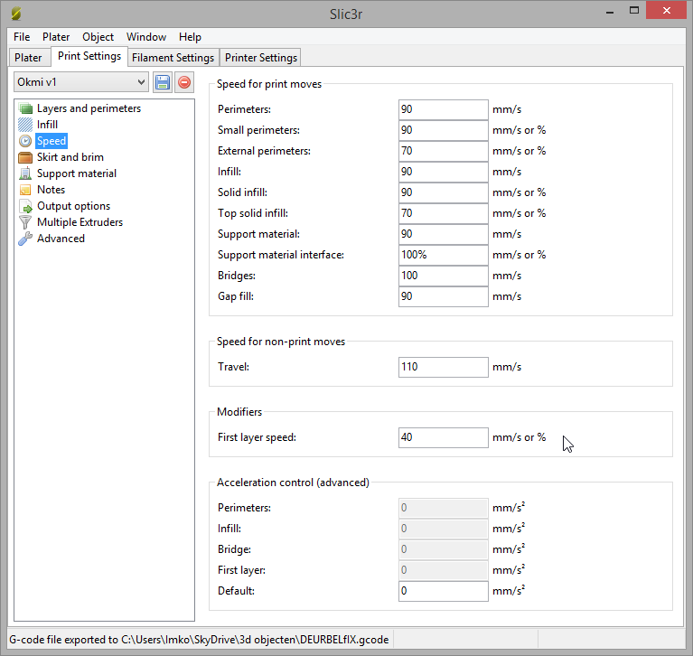

    The purpose is to be able to mount a casing around it, frond back side panels just for looks. This a verry sollid build!, my normal print speed is 90mm/s with 70 mm/s for the external perimeters and 100 mm/s for the bridges (Slic3r). But I have tested and printed successfully at 200%
