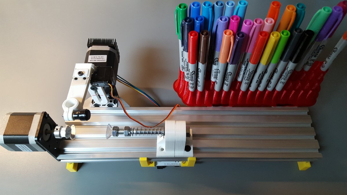

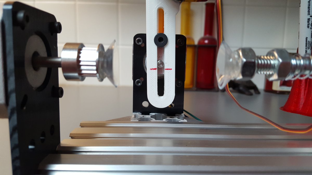

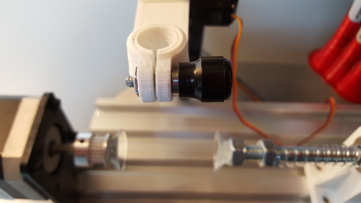

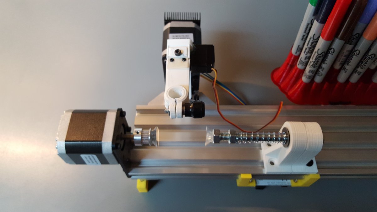

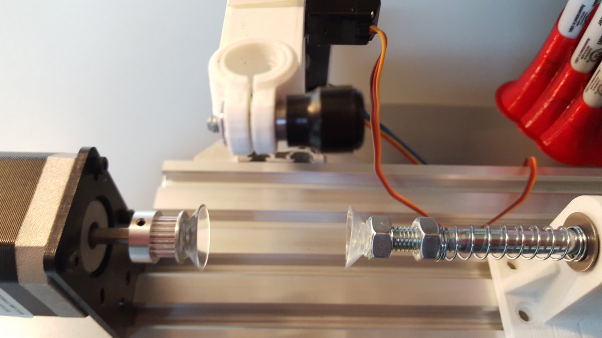

    Any more information on how you built it? What did you use for the head and tail stock?
  4. gianakop
    gianakop Well-Known
    Feb 27, 2015
    15
    Sorry for the delay response.....
    Does the next image answer your question?

    I have considered building one of these, could you post a couple photos of the parts that hold the egg in place. Were they parts you made or purchased?
    Thanks,
    Larry
  7. stargeezer
    stargeezer Veteran
    Feb 20, 2015
    259
    77
    Sorry. Everything is in the files folder. Thanks

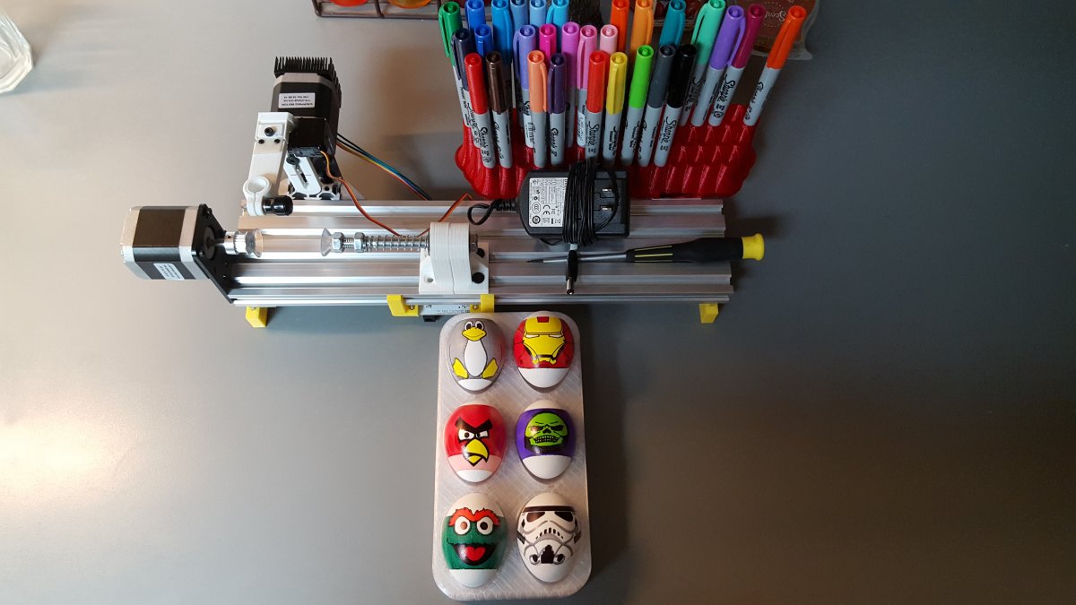

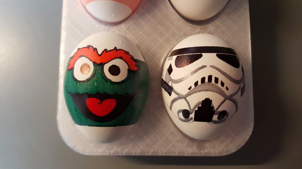

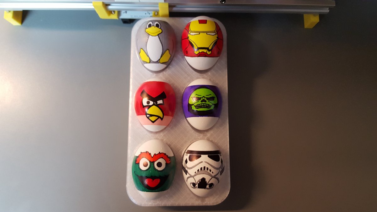

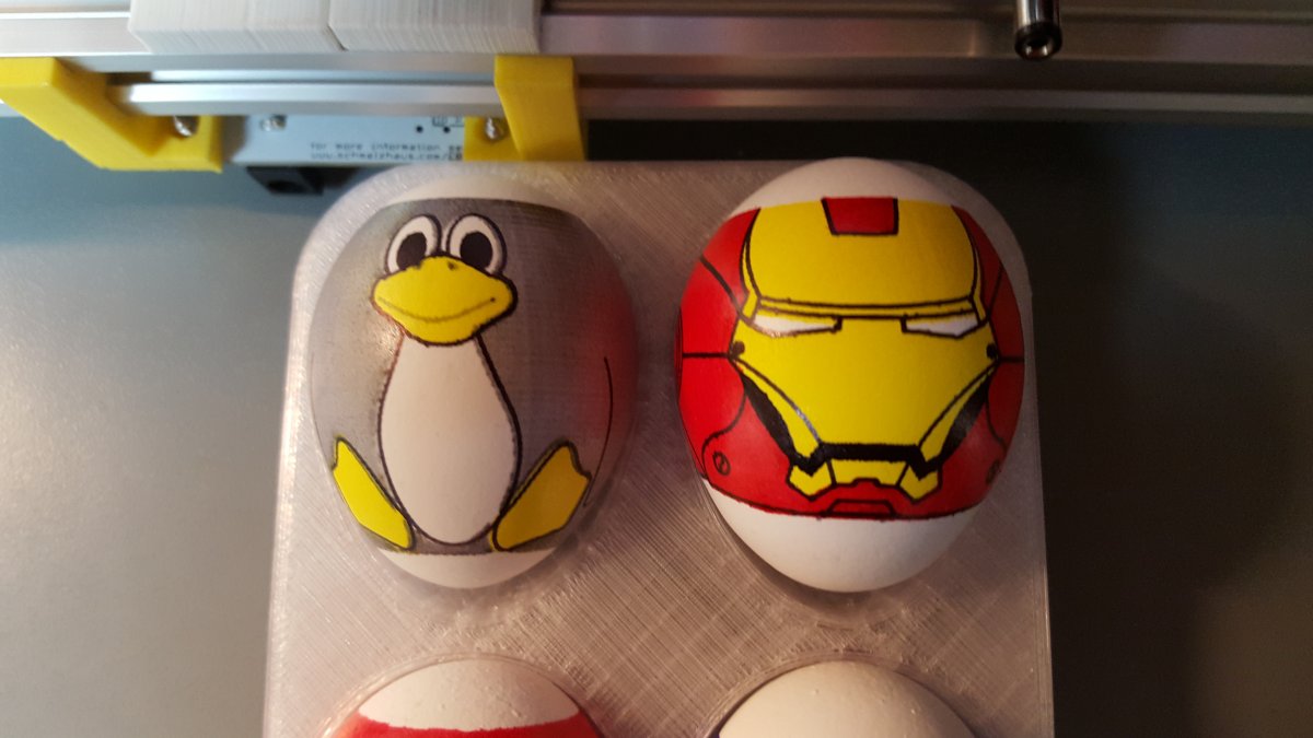

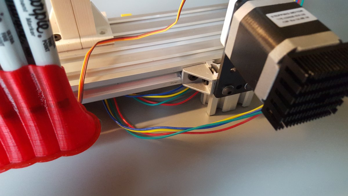

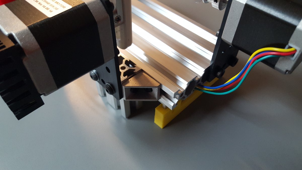

    Thought Id give this build a shot myself. Glad I did, it was fun.
    Im going to start working on mounting other items such as wine glasses, light bulbs, and ornaments.
    Feel free to ask questions and I can answer them here. Ill include some detailed pictures to help folks out. I modified some various parts but the files gianakop included here, work very well.

    Slobberknocker , you have done excellent work! Awesome!

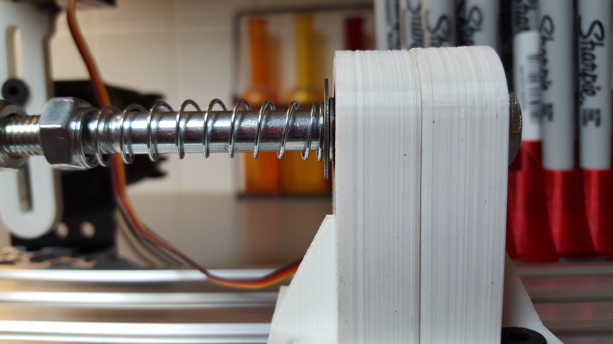

    I can't find the part opposite side from the [egg rotating] motor, the bracket that holds a bearing and a rod with spring...
    Anyone care to share it, or should I design it myself?

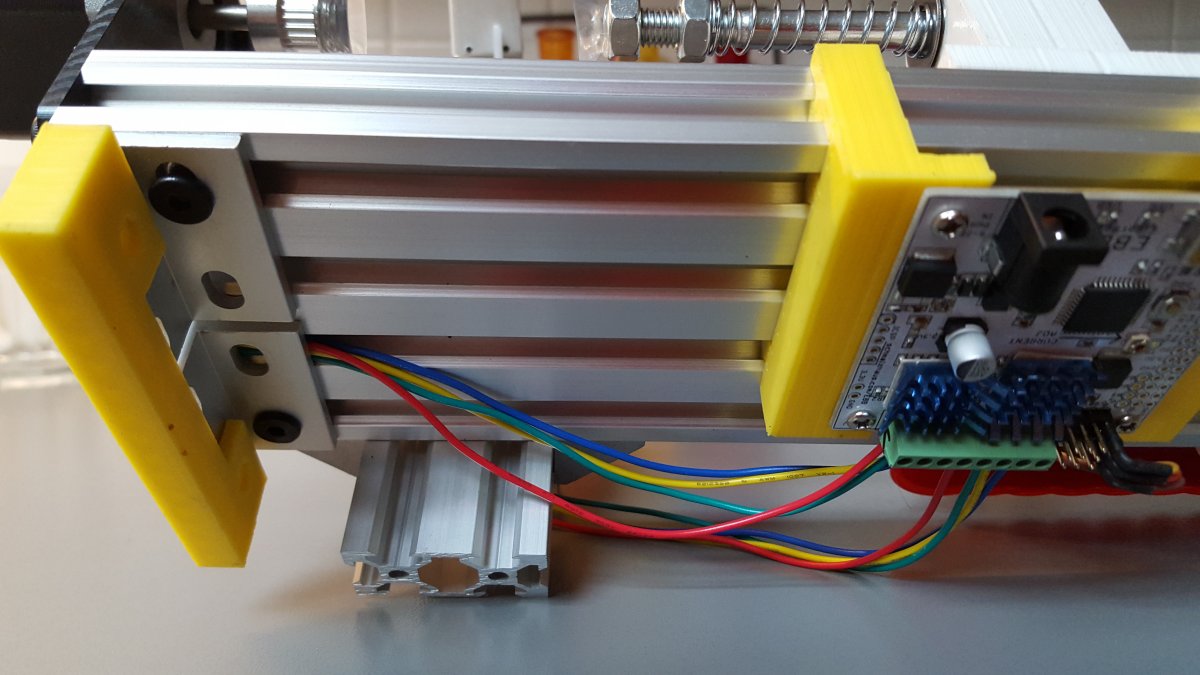

    What controller / motor driver is being used here? Are there plugins for Inkscape required?
  17. Mark Carew
    1,890
    1,002
    @BruceLunde have a look at the Files tab of the V-Slot SphereBot here: V-Slot SphereBot | OpenBuilds
    You can download All software needed for this build.zip in the Files and Drawings tab of the Build
    For a controller we used the simple EBB EiBotBoard Info - EBB (EiBotBoard)
    It controls 2 steppers (one for the pen and one for the egg rotation axis) and a simple RC servo to lift the pen up and down.

    I used a model airplane CA hinge and it only needs a gap of 1-2 mm.

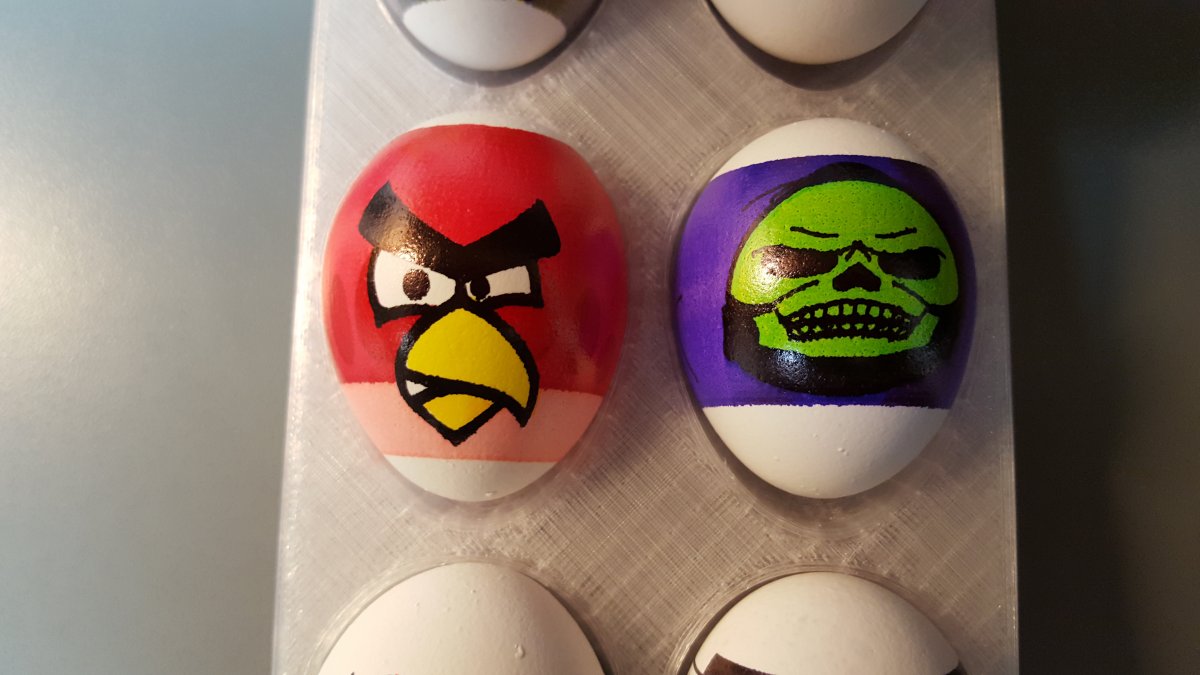

    Hey man! That looks awesome! Question of the day (I am asking because I have not built one of these and have no idea how it works yet)
    How did you get the pictures to put on those eggs? are they just regular pictures you got off the internet and in the software it wraps the picture onto the egg?
    Is it very difficult to get the picture to fit the egg?
    How does the "Changing color" work? how do you get it to stop so you can change markers and such?

    I'm the wrong guy to answer any of your questions in detail, I'm more a hardware guy, but I'll share what Little I understand. :) Worth every penny I charge too. :)
    The link between the three software programs are the key. The CAD program allows you to draw the image, lines and such you mark on the egg. Some packages will allow you to import graphics at this stage, but I found handling graphics in the CAM package worked better for me. The output of your CAD package produces are essentially straight lines on a flat plane.
    Next up is the CAM software that takes the flat CAD generated object and figuratively wraps it around your egg, in a virtual wire form where lines of the 2d drawing form the 3d shape of the egg. Depending on the software you can drop images on the egg at this point. Truth is always the best policy, so I have to admit that this was where I seemed to have my problems. I know it works, I eventually got everything working, I just don't fully understand why it works. It just does, and it's pretty cool. My kids were amazed. Shoot, I was amazed!
    Lastly the firmware installed into the controller card take the output of the CAM software, reads limits to determine start points and follows the instructions it created. These are dependent on the controller board use, just like Apple software will not run on a PC.
    The short answer is that it's just magic.
    Have fun!

    I wish I had seen this sooner. I am glad Stargeezer commented or I wouldn't have noticed. Anyways, you use Inkscape software for the CAM and the "CAD." There is a whole bunch o' pictures on Thingiverse to download. Search 'eggbot' MakerBot Thingiverse. I have made a few of my own as well. Here is a tutorial: Making your first plot - Evil Mad Scientist Wiki I will throw this in the resources section if it isn't there already.
