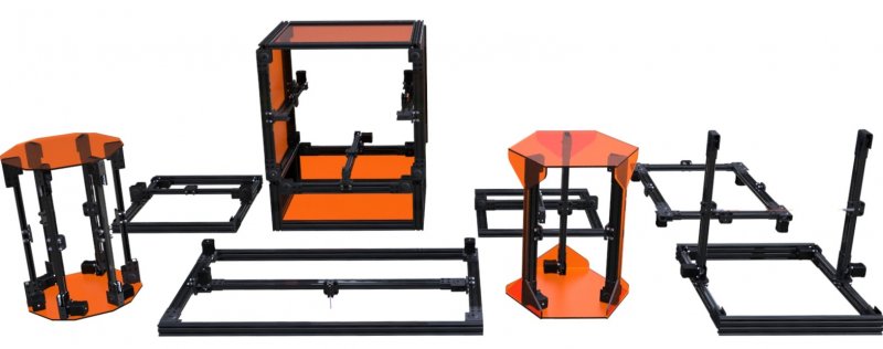

  4. Jae Le
    Jae Le New
    Jun 29, 2014
    The example photo with the mini V logo below, I want to build that! Looks like a perfect setup for a 3D printer where the bed doesn't move. My only concern is the z axis might not be able to make small movements. Would you have a BOM for that specifically?
  5. Mark Carew
    2,744
    2,409
    Hello @Jae Le ,
    The BOM is the same as the parts list shown under the parts list tab here:
    http://www.openbuilds.com/builds/mini-v-linear-actuator-build.48/#openbuilds_parts_list
    This list will build one of the actuators (with lots of little parts like the screws and such left over to build more of them) you would use the size V-Slot you want (in the picture its the 20x20) So if you wanted to build the machine in the example you would need 5 of the actuators.
    Hope this helps and make sure to watch the video and download the example models (Files tab) to get a better understanding of how to build your machine.
    Have fun with your build!
    Mark
  6. Jae Le
    Jae Le New
    Jun 29, 2014
    Thanks for the info. It looks like only the z-axis is 20x20. The x-axis and y-axis appear 20x40. Any idea when the actuator end mounts will be available?
  7. Mark Carew
    2,744
    2,409
    Welcome @Jae Le :)
    Looks like about a week we should be back in stock on the end mounts.
    Hope this helps
    Mark
