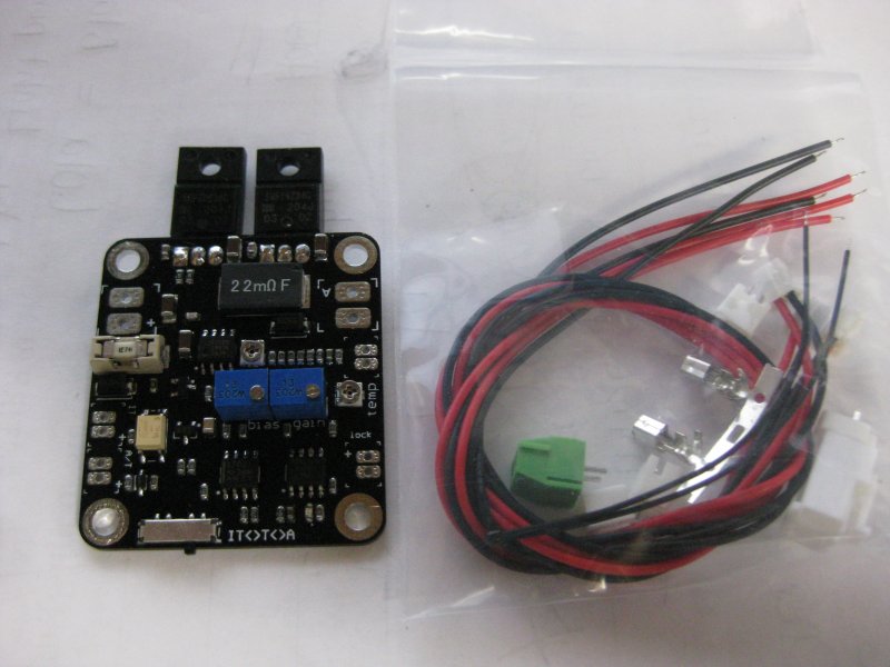

    UPDATE 08/15/2015

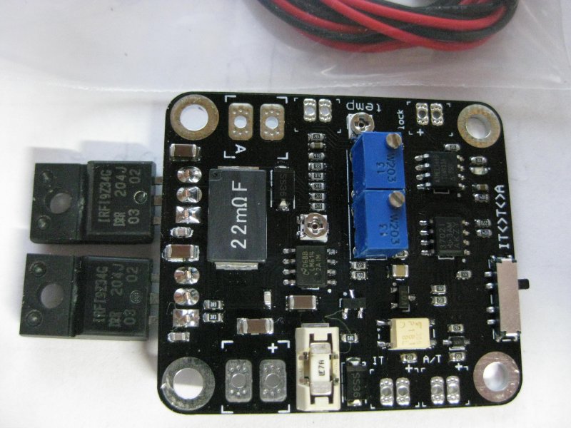

    Alot going on right now, we're upgrading the laser to a 6 watt 445nm laser diode with a 3 element lens along with a analog/TTL driver capable of pushing over 6 amps of power. We're going to keep it throttled down to 4.5 amps though to increase the diodes life span, should give us just over 6 watts of beam. I just received the driver, just waiting on the diode and heatsink now.

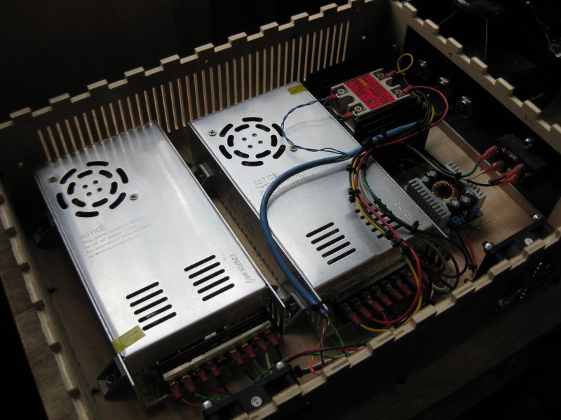

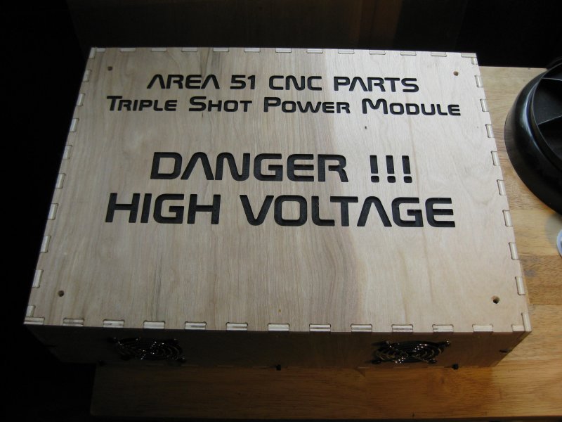

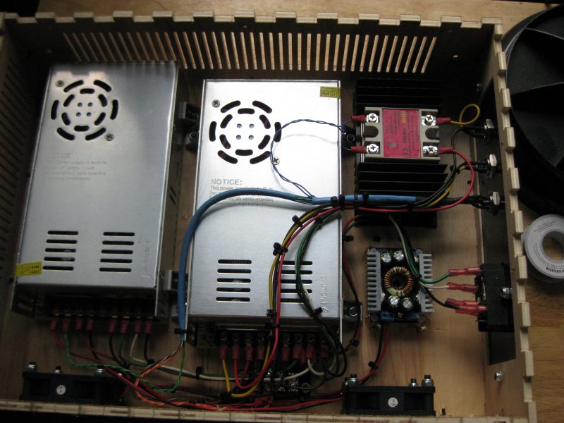

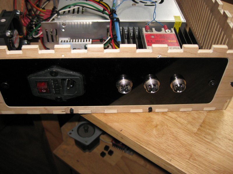

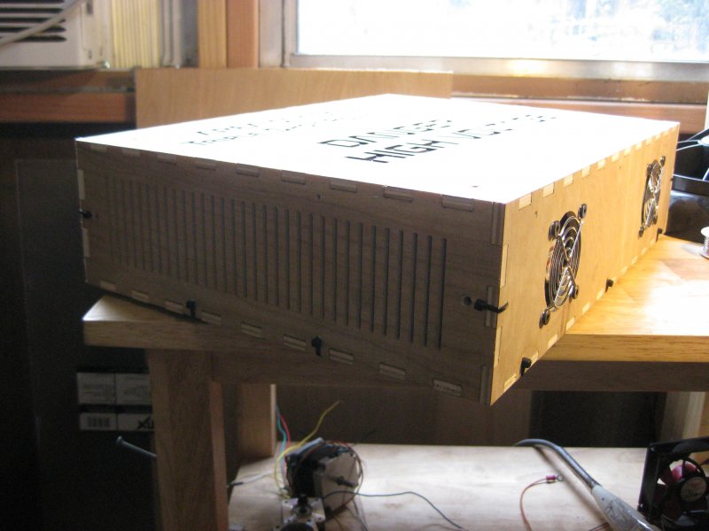

    UPDATE 08/26/2015
    Ok i've completed the power supply module finally, it consists of 2 - 24V 15A switching power supplies tied together to double the available current (30A) for the 2 MK2 heatbeds we're installing for the 3D printer setup, 1 - 12V 10A adjustable step down buck drive to provide power to the fans and the laser driver, and 1 - DC-DC SSR to turn the heatbeds off and on. This power module will be able to provide the power for the Laser, 3D printer, and CNC router with all the associated electronics.
    [​IMG][​IMG][​IMG][​IMG][​IMG]

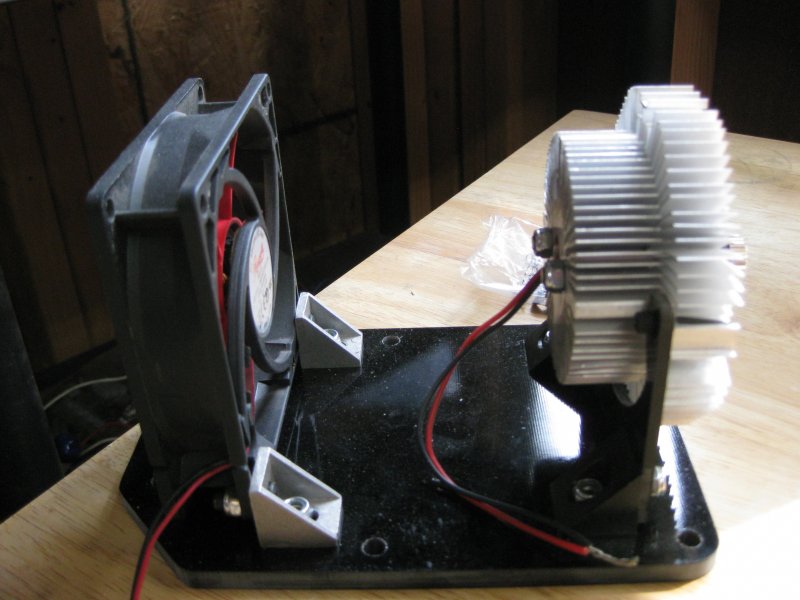

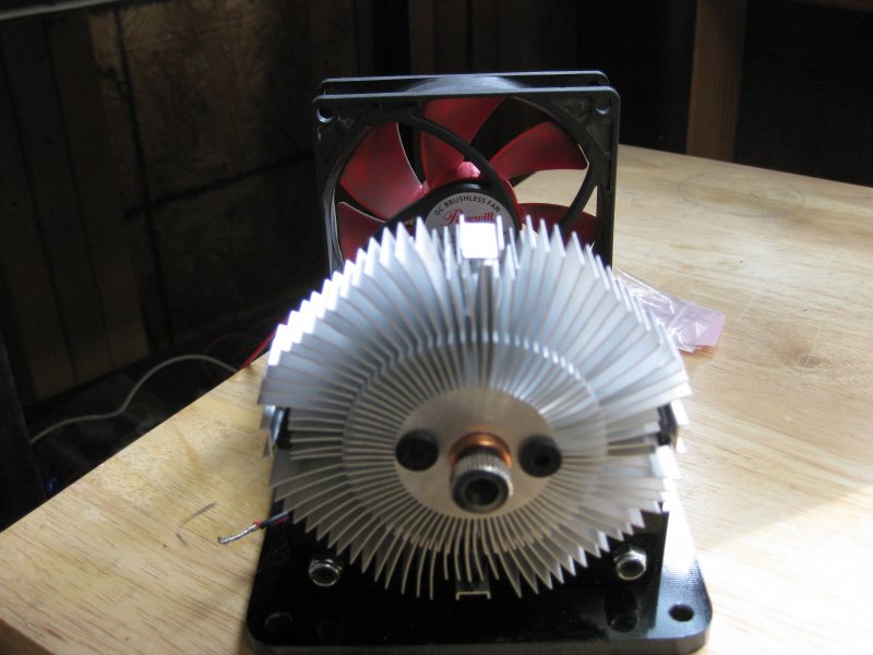

    I have both a FlexMod P3 and a 6.2A adjustable driver for the 6W laser diode, and I just finished the custom heatsink host for this diode.
    [​IMG][​IMG][​IMG]
    I am now working on the CNC Router/Laser electronics module and hope to have that completed this afternoon. I will upload some photos and a breakdown of the components here when I get it together. Stay tuned !!

    Thanks Mark ! From what I understand the 6 watt is about the strongest on the market right now, should be able to cut 1/8 ply with it fairly easily. Pushing 4-5 amps to the generates alot of heat so good cooling for the driver and diode is essential.
    What driver is that Michel and do you have a link to it? The water cooling option looks great, I was thinking of modifying a CPU water cooler setup with a custom CNC'd copper block to house the diode, should be able to keep the temps down..
    Gerald

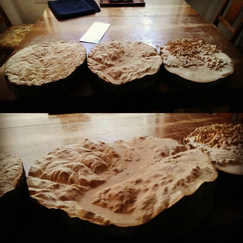

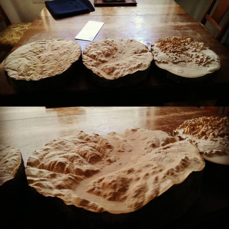

    Your 6W laser sounds way more what I am looking for. Basically the ability to cut through 1/8th baltic ***** and door skin.
    I am pretty new to the whole laser situation, do you plan on posting a BOM for you laser at any point or would you mind sharing the info on what parts from where you found them? I would even be happy to purchase them through you (Area 51) if you were interested in putting a DIY kit together of the pieces. Looking to move ahead with the laser soon tho so let me know either way.
    I have been carving these 3D contour maps and need to be able to etch into them, shore lines, roads, place etc...
    The plan is that a laser will be able to do it without loosing the atheistic of the natural wood.

    The 6 watt isn't bad, in my opinion it's better to have more than what you "currently" need, you never know what you might like to try in the future.. Plus the 6 watt is throttled back with PWM so it can run from just barely on up to full power, works great for doing fast grayscale images..
    The 3D topo maps are great, love that idea... You might want to check out picengrave.com, they have a cnc/laser program that can carve the contour map then lay laser engraving right over it for shading and such without resetting the piece.. If you don't mind me asking, what software are you using for the relief? I have a couple but have yet had the chance to try them out...

    I am just using an old version of Aspire to make the maps with GIS data.
    picengrave.com is exactly the software I was looking for, thanks.
