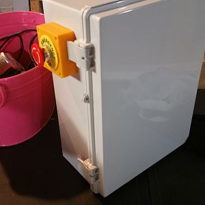

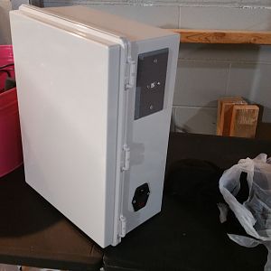

  6. Braindice
    Braindice New
    Jul 17, 2017
    So had a chance to work on the control box -
    I mounted on the control box the E Stop button and a USB port as well as a power plug
    Not a ton of work done but gets the few parts I had in a box and ready for stepper controls and such.
