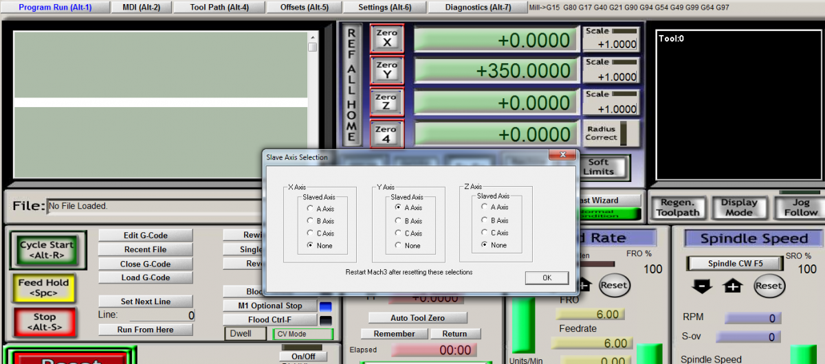

    Starting my first cnc project and trying to build electronics. Using breakout board (SainSmart 4 Axis Mach3 STB4100) and ST-40-45-A1 controllers.
    Everything looks working well, but when i loading sample g-code and run it, then only Y axis moves, slave A not moving at all?
    In jogging mode Y and A moves together and A reversed nicely. Are there special g-code needed to run on slave A? Thats not logical?
    Can someone help newbie?
  8. Steven Bloom
    Steven Bloom Journeyman
    Dec 18, 2014
    194
    104
    In Mach 3 go to config and then slave settings. Here is a config pic. My A axis mimics my Y axis.
  9. Priit Paat
    Jun 18, 2015
    Thank you for answering, but I have already made this setting. All works when i jogging. When I load arbitrary code, then A axis will not move.
