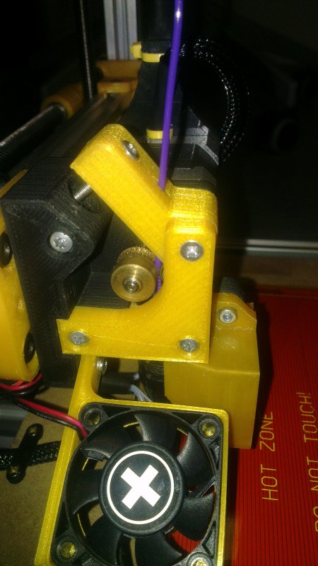

    Hello :)
    Small update, I did a test at 100 mm/s, and the result is not too bad.
    Video : https://www.dropbox.com/s/0x2wr5d6r9plb33/2014-01-20 15.57.30.mp4
    But at that speed, a new extruder is a must!
    I lost too much time the last day trying to draw the best extruder possible, but nothing is left ... except a dirty upgrade which works not bad.
    I have uploaded the new files until I find a better solution.
    - extruder flange - dirty upgrade.stl
    - extruder idler - dirty upgrade.stl
    At the moment I prefer to spend my time doing a build manual and print a maximum of things to validate the concept.
    Peace.

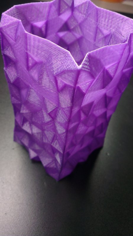

  16. Mark Carew
    2,746
    2,412
    The valentine vase came out really cool looking!
    I also love the look of the build manual very easy to follow.
