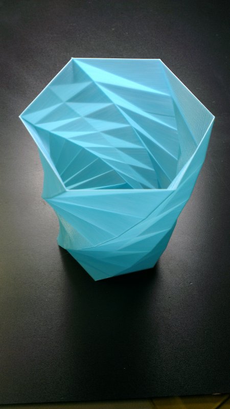

  9. Mark Carew
    2,745
    2,410
    The new pics you post look fantastic! I really like this one
    The prints are coming out great on this machine
