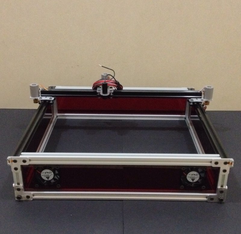

  14. Robert Hummel
    Robert Hummel Custom Builder
    Moderator
    Nov 14, 2013
    978
    714
    I myself don't have the issue of light going out the window as most of it is absorbed by the acrylic.
    I do not know its rating on protection but it does help a lot.
    That housing is to small for what I
    designed but a little creativity can solve that.
    I'm not able to finish it the way I want because my desktop mill is to small.
    When my OX AI is done I will be able to complete my build :)

    Change of plan i will be using the laser cutter in a room with no window and only 1 door if i will be running it in there will i still need the enclosure or i still need it will it be fine to have it like in the photo so no laser light goes in the direction of the door[​IMG]
  22. Tweakie
    Tweakie OpenBuilds Team
    Moderator
    Jan 18, 2014
    784
    326
    @Wojtek there are two main safety aspects to be taken into consideration when using lasers...
    1) Protecting eyes (yours, pets, bystanders etc) from direct or reflected laser beams and you seem to have this covered OK :thumbsup:
    2) Protecting lungs (yours, pets, bystanders etc) from the fumes produced when laser cutting. Lasers will vaporise many materials and the particles / fumes produced can be extremely toxic. Unless you include a fume extraction system (I use an overhead ducted system) vented to the outside atmosphere it is unwise to operate any laser in a closed space. You really need plenty of ventilation and a room with 1 door and no windows is, in my opinion, not a satisfactory location.
    Tweakie.

    well a room is not a good description a better one would be a metal shed in the back garden.
    for fume extraction system i think it would be best to have the laser cutter in a sealed container(or something) and have 2 fans with tubes going throught the roof. what would be a good way to make a container for the laser cutter
  24. Wojtek
    Wojtek New
    Apr 29, 2014
    32
    Hmm toxic fumes over populated area i dont think that would be a good idea.
    i know hardly anything about fume extraction so give me info about it designed for a noob
  25. Tweakie
    Moderator
    Jan 18, 2014
    784
    326
    I can’t offer any advice on what would make a suitable enclosure so I think you would just need to use common sense here. I recently used some smoke capsules (used for testing boiler flue installations) to check the efficiency of my extraction system.
    Lung contamination / infection etc. can take many years to actually show that a problem has been caused so stay safe and always have plenty of ventilation in the work area.
    Just a couple of examples of problem materials…
    1) PVC and materials containing PVC will give off Chlorine gas when vaporised by a laser. This Chlorine combines with the natural moisture (water vapour) in the air to produce a form of Hydrochloric acid which is both harmful to us and our machines.
    2) The typical ‘B&Q’ purchased MDF will give off Formaldehyde (when attacked with a laser) and because this poses a significant risk to health many have now changed to using the safer ‘Medite’ (brand name) which uses a water based bonding agent.
    3) There are many more materials that could be added to this list.
    The actual volume (p.p.m) of toxic fumes / particles produced is relatively small and they quickly dissipate to a harmless level when vented to the atmosphere, however, I use a H.E.P.A / active carbon filter in my extraction system – mainly just to remove the smell of cutting acrylic but then again I am not in a highly populated area.
    Tweakie.

    tonight I was bored and so I mocked up my design.
