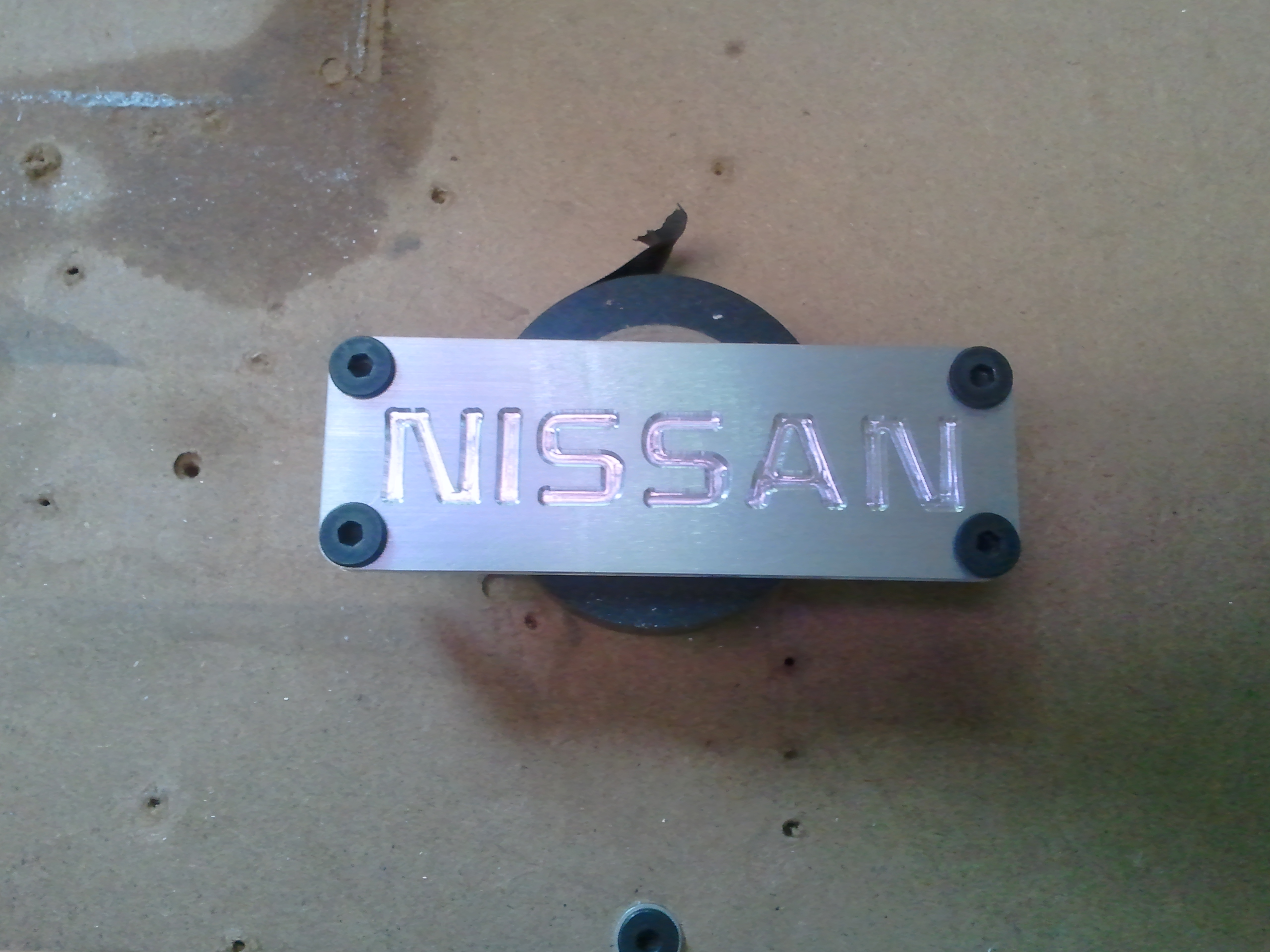

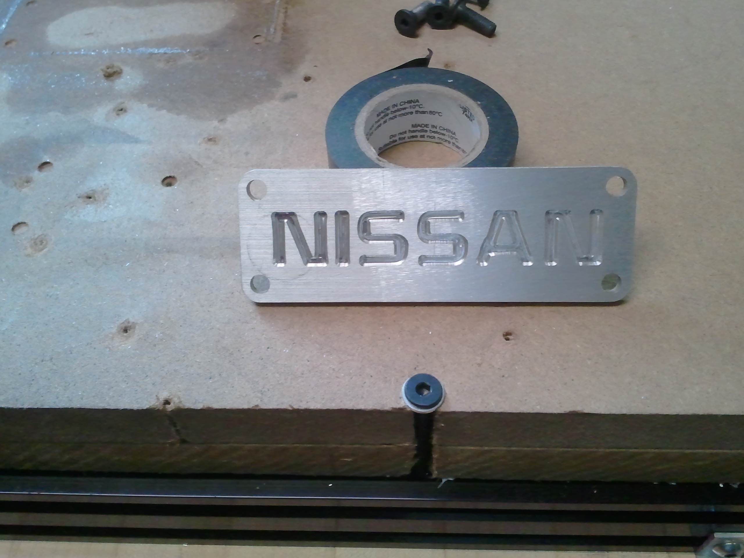

    I started off w/ some tests in MDF since it's most forgiving, went to some tests in lexan, and then finally cut some aluminum today!
    I seriously messed up cutting the logo in one program and attempting to cut the holes from another program and screwed the alignment all up, but the logo turned out nice for a vbit that I accidentally knocked the tip off while jogging one day, so I ground it flat and made it a flat tip vbit.
    So I learned from the misalignment issue and made another attempt, successfully this time!
    [​IMG] [​IMG]
    Unfortunately it's not without it's faults, I screwed up yet again and entered a number in the wrong field which caused the engraving which was supposed to be three passes but instead ended up being one full depth pass! it was a little too much for the machine to handle which can be seen on the bottom left of the A.
    Anyways, I'm very happy and excited to have my machine in good running order so that I can start using it!
