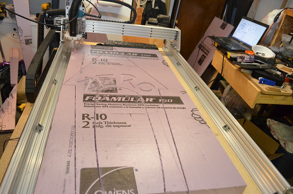

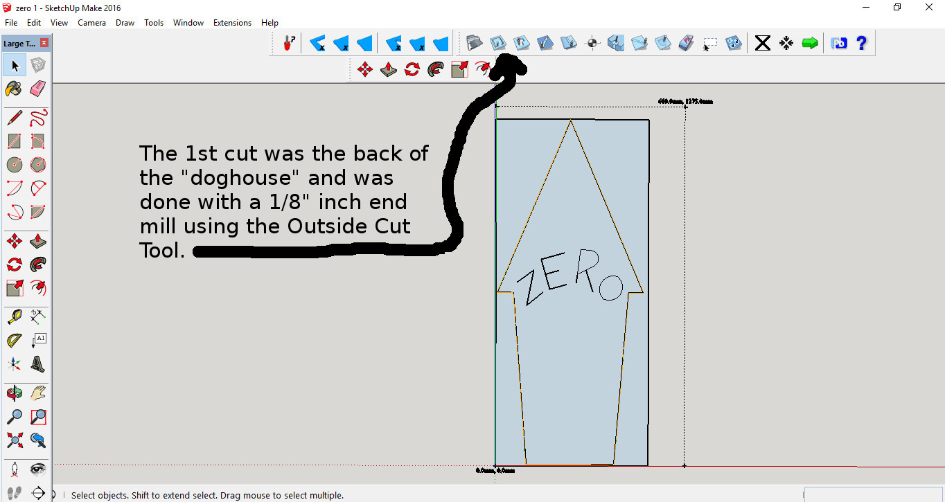

    First, I used a table saw to cut the 4' x 8' sheet into four 2' x 4' pieces. I used two of them for each doghouse gravestone (4" thick total). I made one for me and one for a friend. I had drawn the outline of the "doghouse" and saved it to three different files for modification for the three different cuts:
    I drew and scanned this the low tech way with a pencil and paper and traced with a black sharpie. It was "trace bitmap-ed" in Inkscape to sharpen it up:

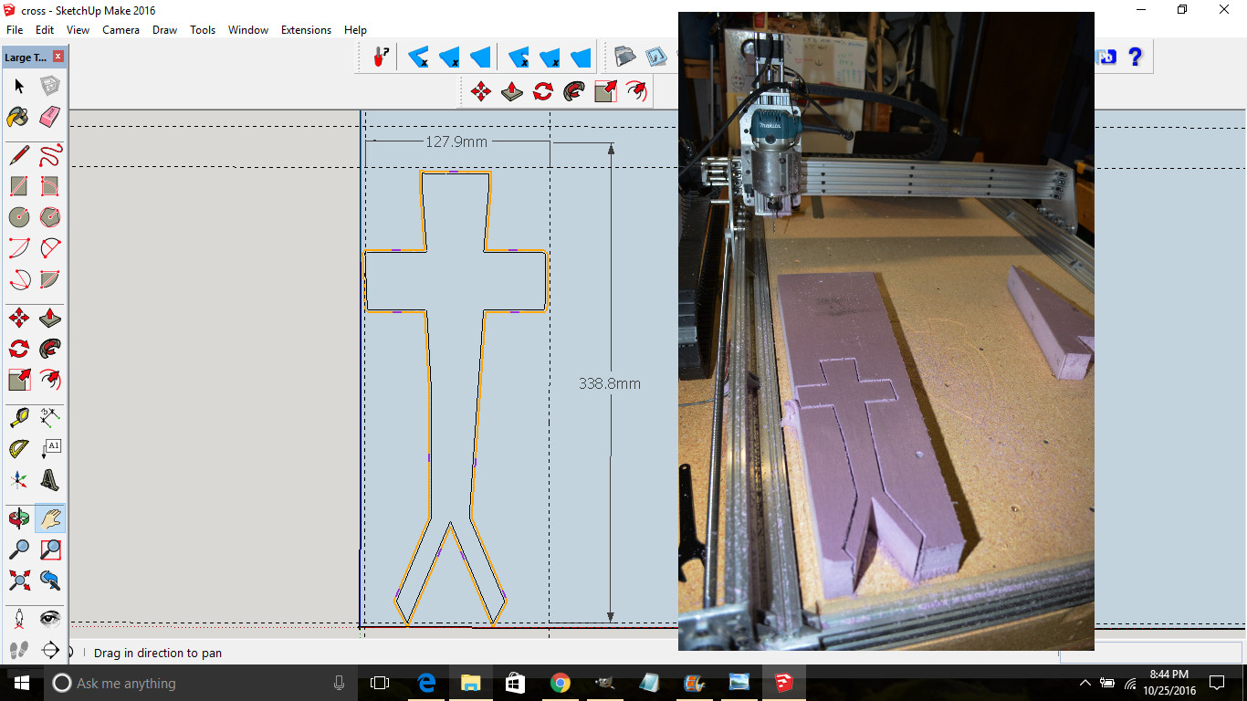

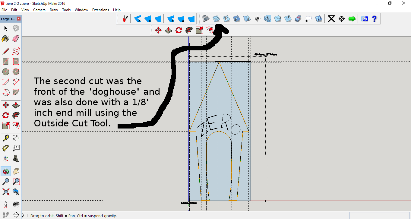

    Using Fengrave (engrave function) I sized it so it could be cut from the remaining foam in the doghouse door using three passes of 17.5 mm each with a 1/8" endmill. The "second cut" foam remained attached to the table for the second cut, engraving of the letters, and cutting Zero's skull and crossbones. I wanted the bones and skull to be recessed so I sliced them in half (1 inch thick) on a band saw making two copies.
    I also cut the cross from some foam scrap after doing a quick sketch:

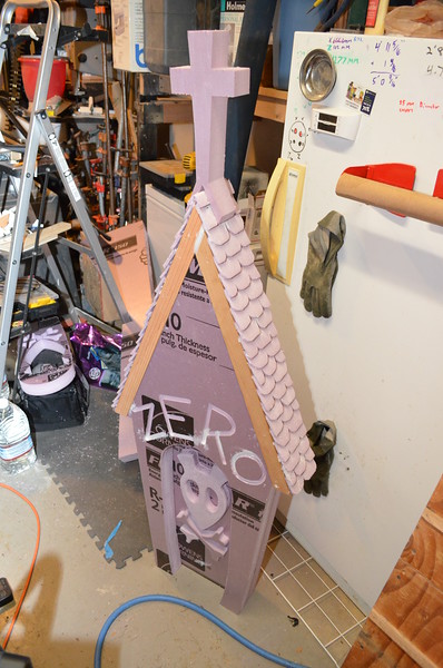

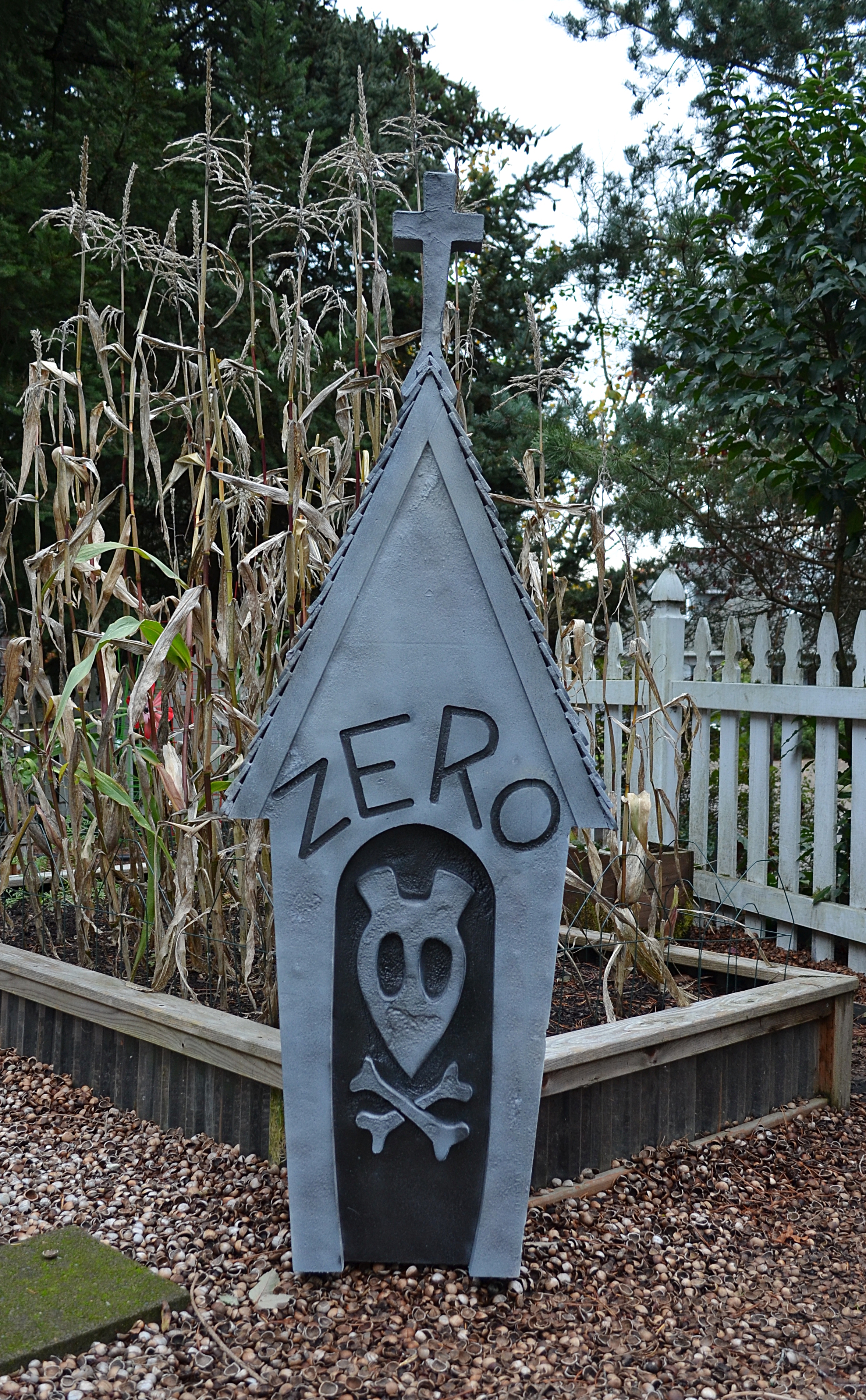

    Here it one glued up prior to painting. I cut a bunch of 1/4"x 2"x 4 1/2" strips with the band saw, which I then cut the shingle shapes out of on the scroll saw. I stacked about 4-6 of them to speed the cutting.

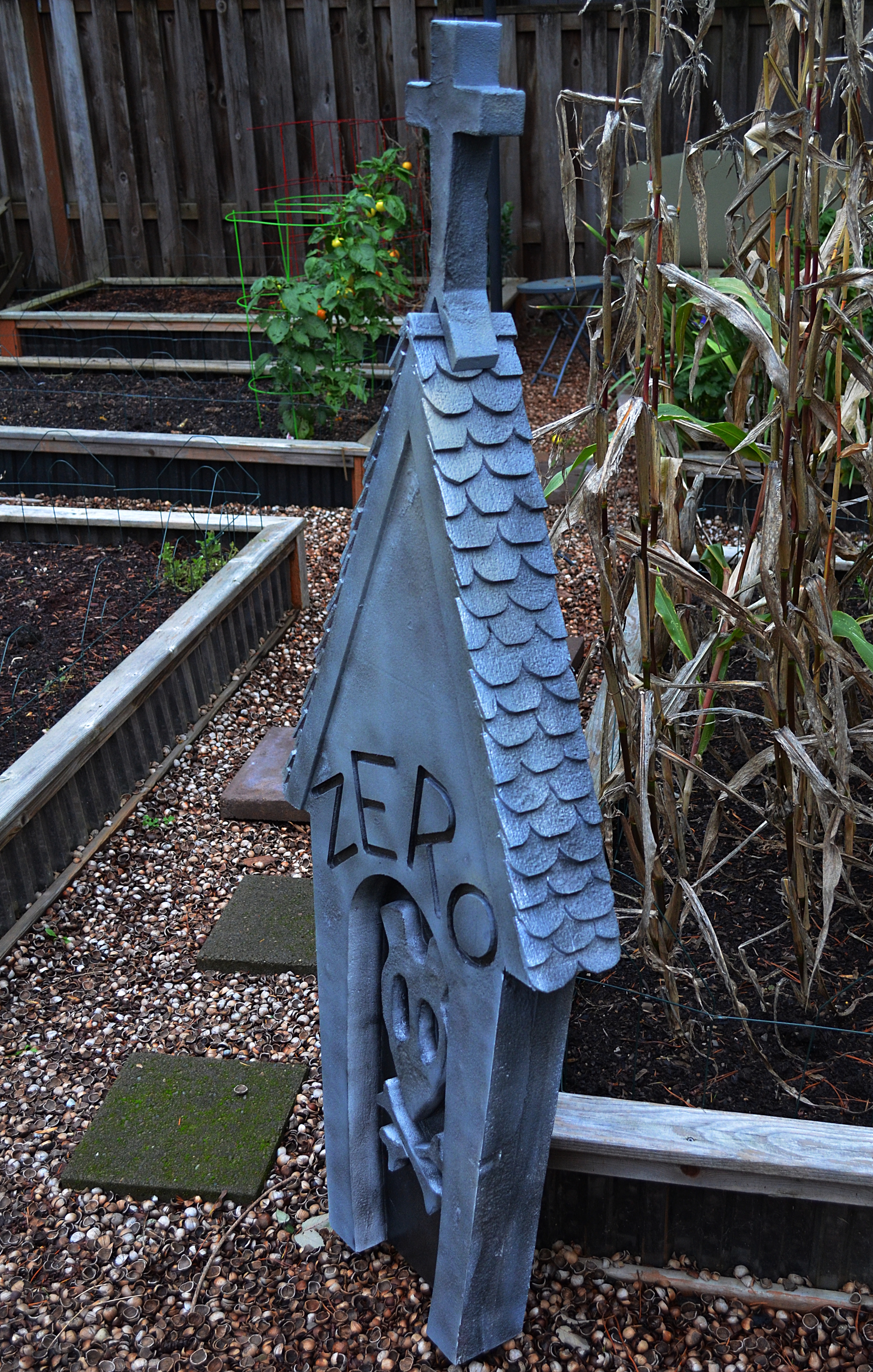

    Finally, I broke out the rattle cans and, after priming with interior/exterior latex, I painted them. Spray paint by itself ate the foam. Finished product:

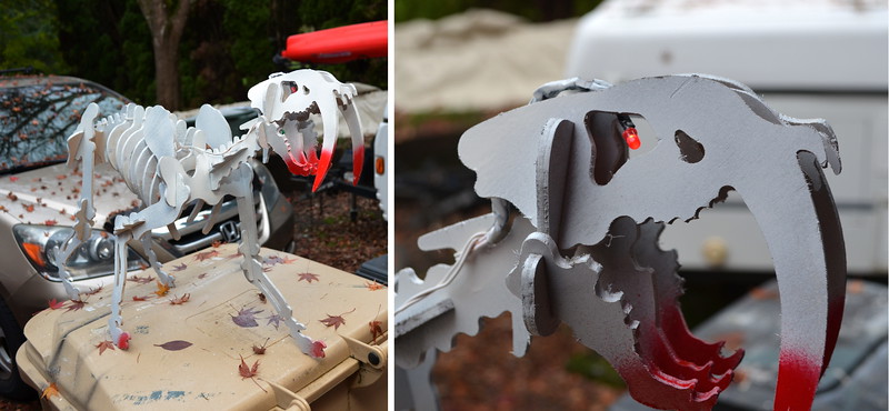

    Just finished up my sabertooth skeleton. I put a couple red leds in the eye sockets with the battery pack hidden behind the pelvis.
    MaryD and Kyo like this.

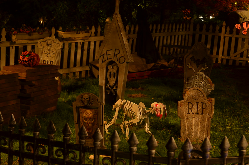

  7. Giarc
    2,921
    1,620
    Here they are together. I can only claim Zero's grave as my handywork besides the sabertooth skeleton. The stacked op pavers are for an unrelated project.;)
