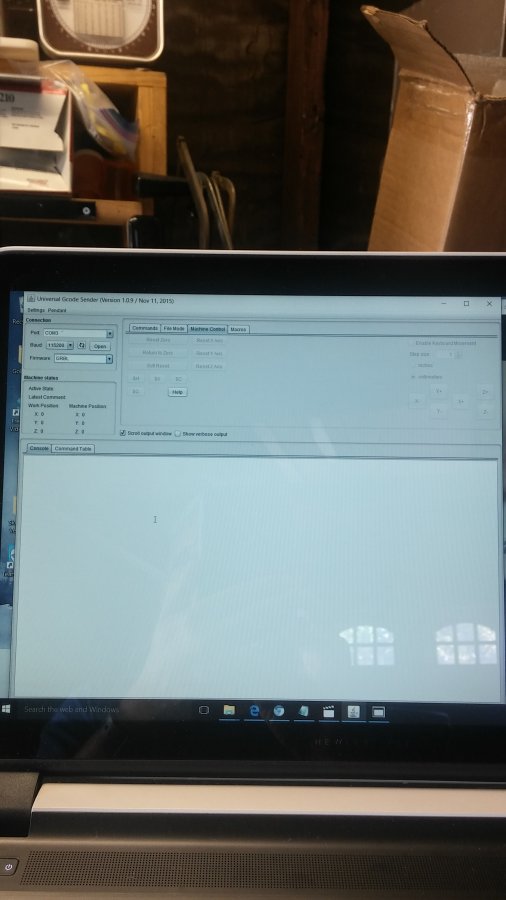

  11. blindflight
    blindflight Well-Known
    Sep 19, 2013
    53
    56
    Message_1473444708519.jpg Having prob with seeing my settings (see pics)
  12. Giarc
    2,923
    1,620
    It is too small to read for my eyes. Also it appears to be Universal Gcode Sender not GRBL Panel.
  13. David the swarfer
    3,288
    1,837
    click the 'commands' tab
    type $$
    press enter
    all the grbl settings will be spewed forth onto the screen.
    to change a setting, just type it like this in the command edit box
    $100=26.666666 <press ENTER>
    that would set X steps/mm to 26.666666
    DO NOT change settings unless you actually know what they do!
    Configuring Grbl v0.9 · grbl/grbl Wiki · GitHub
