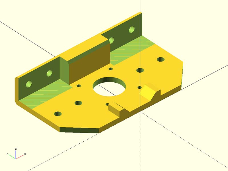

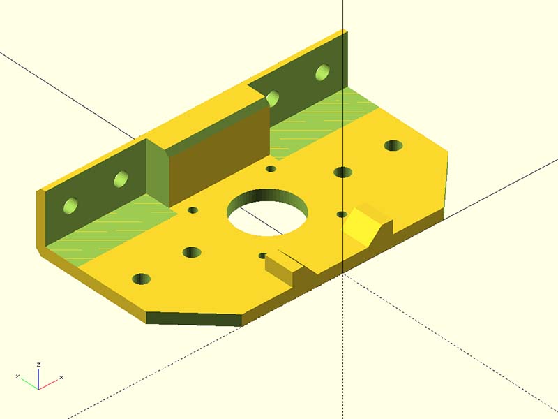

    If you are interested, I can take a stab at converting these plastic parts from 2020 to 2040 in openscad? I kind of like these puzzles. I took the liberty of doing the Y-Axis End Plate (maybe it should be called front plate) based on what I saw in your drawing for the12" to see how it went. I made the openscad file so you can cut out some of the center mass to use less plastic, but can also leave it filled by setting the variable CutSize in the openscad file. I chamfered the edges instead of rounding as that is much easier in openscad. Here are the files.

    Thanks David. You can probably tell by my images that I use OpenSCAD. I haven't started modding the parts yet as I am waiting for the build plate to find the final spacing of the Y rails. I'm always trying to learn new tricks with OpenSCAD so will take a look at your files. My final front piece will probably be very different than this though as I have a 7" PanelDue display to mount and the front was one of the options.

    Ok, I won't take it any further than this. Here is the back matching plate.
