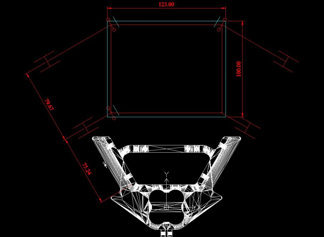

    Is there some optimum width between the pairs of Delta Arms? I have not seen where anyone has mentioned this. I was checking some dimenions on mag effectors on thingiverse & saw dimensions of 46,50,54 & one that was over 70mm between the centerlines of the pair of rods. Looks like the Traxxus carriage I was starting with was about 60mm.

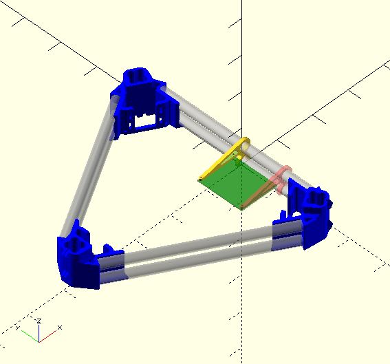

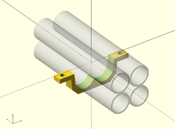

    I put this project aside as it seemed to be too much trouble for me to use EMT for a Delta. I have since built a Folgertech Kossel Mini & may work on another 3d printer this winter. That being said, I took a look at your problem & came up with this possible solution for you. I added a zip file to file area called: EMT_DuetElectBrackets_161010.zip which has 2 openscad files, 2 dxf files & 2 STL files generated from the openscad file. The dxf file is referenced by the openscad file. The dxf file should make it easier to change the brackets if they only need to be adjusted a little.
    I have attached 3 screen captures to give you an idea of how this might work. After I finished these calculations, I forgot about the motor being attached there, so the brackets might have to lengthen some if that is in the way. Currently the Duet board should be 29.5mm from where the motor mounts on the plastic vertex. To get 49.5mm instead of 29.5mm, the tabs would have to extend another 10mm each. Since you are using EMT vertically, I assumed the vertex showed in the 2D drawing is what you are using. The idea of this bracket is similar to the glass holding bracket. I got the dimensions & hole spacings of the Duet board from: Duet - RepRapWiki
    This is of course is untested, so you have to determine whether this will work. Here are 3 photos of the idea. The 2d assembly image, 1st brackets centerline is 75.24mm from end of the EMT & 2nd brackets centerline is 79.67mm from 1st bracket centerline. The dimensions of the Duet board I used are also shown. If the brackets need to be extended by 10mm, that distance from the end of the EMT measures an additional 17.3mm. Let me know how it goes. When you get your machine put together, I would like to see some photos of it.
    EMT_ElectronicsBracketAssembly_rev9.jpg EMT_ElectronicsLongBracket_rev9.jpg EMT_ElectronicsShortBracket_rev9.jpg

    After I did that electronic board mounting design, I thought it might be easier to mount it on the side & should be simpler to assemble & you can put it anywhere along any side. I created these 8mm thick but the other ones were 12mm. Change the variable S_Ht to the height you want in the openscad file. I have an option in the openscad file for you to see how it looks connected to the EMT & vertex. Just set Assemby variable to 1. There are at least a couple of other variations that could be done with this design.
    1. change the support to underneath instead of above, but mounting holes might be a problem
    2. Could also make Duet board mounting holes on a tab extended above or below the extruded profile.
    I have attached a screen shot of the assembly & a zip file with all the parts. Since you gave me the lengths of your horizontals, I made them that size in the assembly. That is a pretty small electronics board.

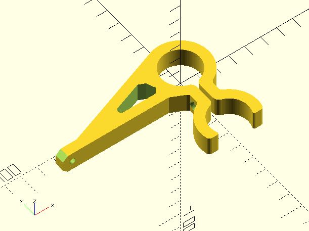

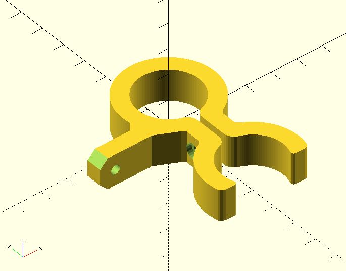

    You got me interested in doing some more design on this project. Not sure I will print any of these, but I will further the design. After working on these brackets, I was thinking it would be easier to clamp something to the top horizontal pipes if there were 2 on each side like the bottoms. To keep the same spacing as the bottom, that would increase the height of the top vertices by 24mm. If 1/2" EMT were used for the top horizontals, I could decrease that 24mm by 10.6mm keeping the same gap between the EMT. I could also cut off a little bit of plastic where the 1/2" EMT butts up against the vertex. If you have not printed your top vertices, does that interest you?
    This would allow me to bolt a modified design of this filament holder to the top & also an extruder. This filament holder has worked really well for me.
    Parametric openscad Remix of Universal stand-alone filament spool holder by GeoDave
    How are you mounting the P/S? I could modify this design: Folger Tech Kossel P/S Bracket with slot opening for T-Nut Connection by GeoDave using the similar clamping that the electronics uses.

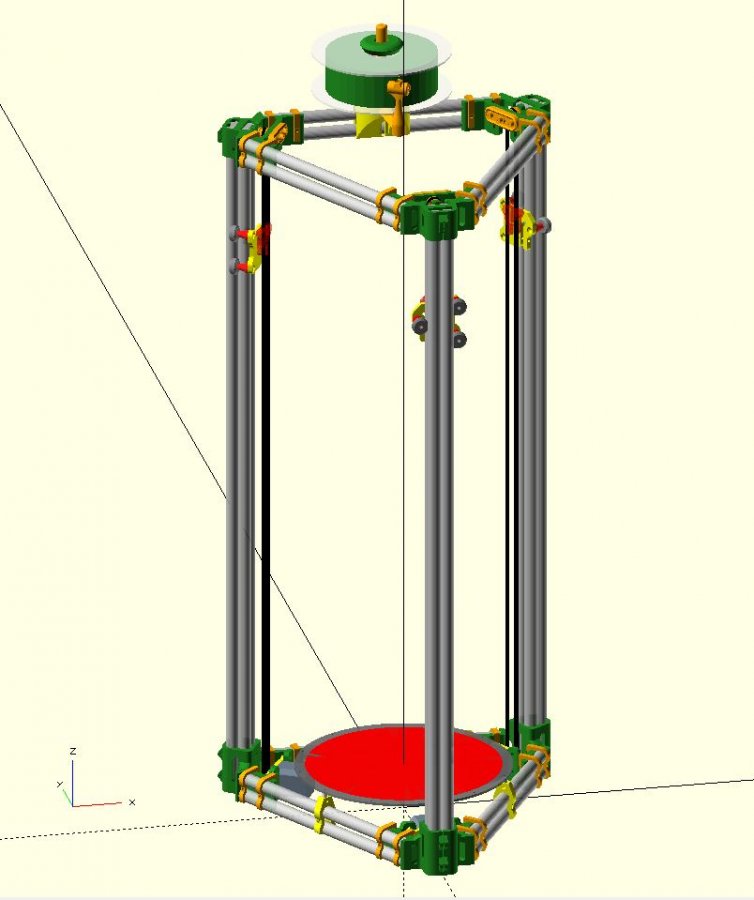

    I have been working on making the parts to use 1/2" EMT for the Horizontal & Verticals & assembling the parts in openscad to see what problems show up. I have cut down the amount of plastic a good bit using 1/2" EMT instead of the 3/4", changing the profiles at the corners & cutting more holes. Seems like it should be just as strong with those holes cut.
    The cubic centimeter volume for the bottom vertex went from 249 to 140.
    and the top vertex went from 131 to 119.
    I am sizing this build for the 300mm heat bed by seemecnc & the height is at 1 meter. The horizontal 1/2" EMT lengths come out to 344mm with the heat bed mounting holes centered on the pipe.
    I have not printed any of these yet, but will ponder the design a little more before doing that or posting the files.
    Here is what it looks like so far.
