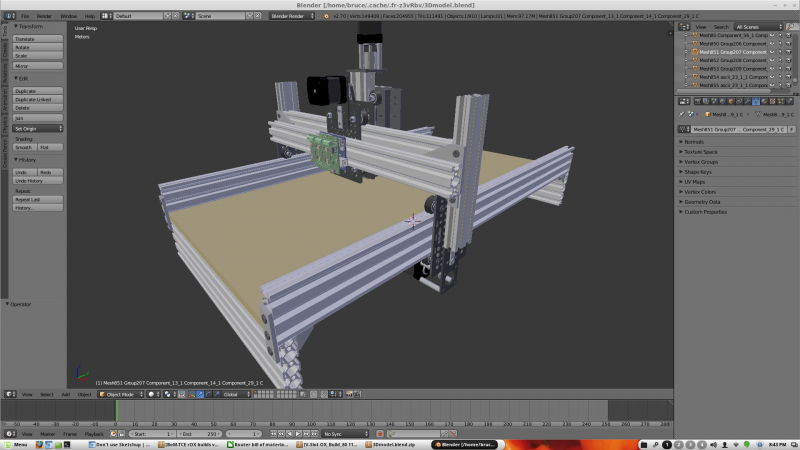

  16. brucewestfall
    Mar 10, 2015
    So, this took me about 3 seconds to open using 100% open source software thanks to "The Dude". This IS called OPENbuilds, right?? Screenshot from 2015-03-10 20:43:47.png
