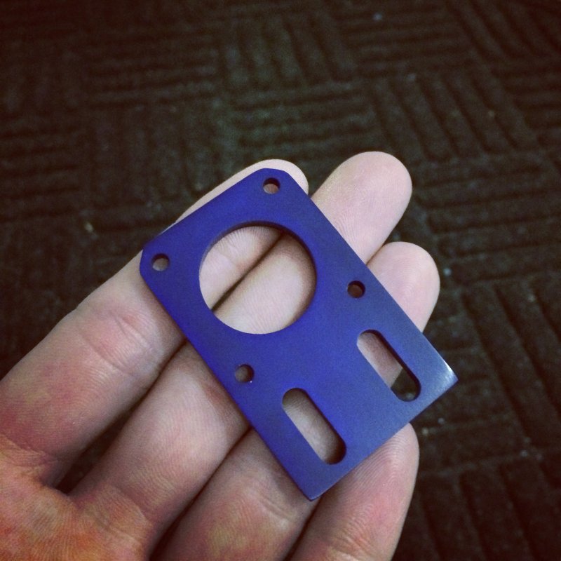

    Well here you have it my first anodized part, it's just a test part as I'm going to have to play with my time ratios :)
    I would say not to bad for the first attempt :p

    Very nice !! Looks great !!

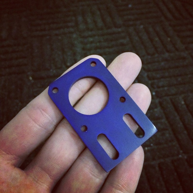

    Here is a shot of part 1 of four for a little build and test in my system ;)

    Dye sure comes out nice... Good deep color !!

    That was 90 seconds in the dye @ 140F :thumbsup:
    pre finish is key
