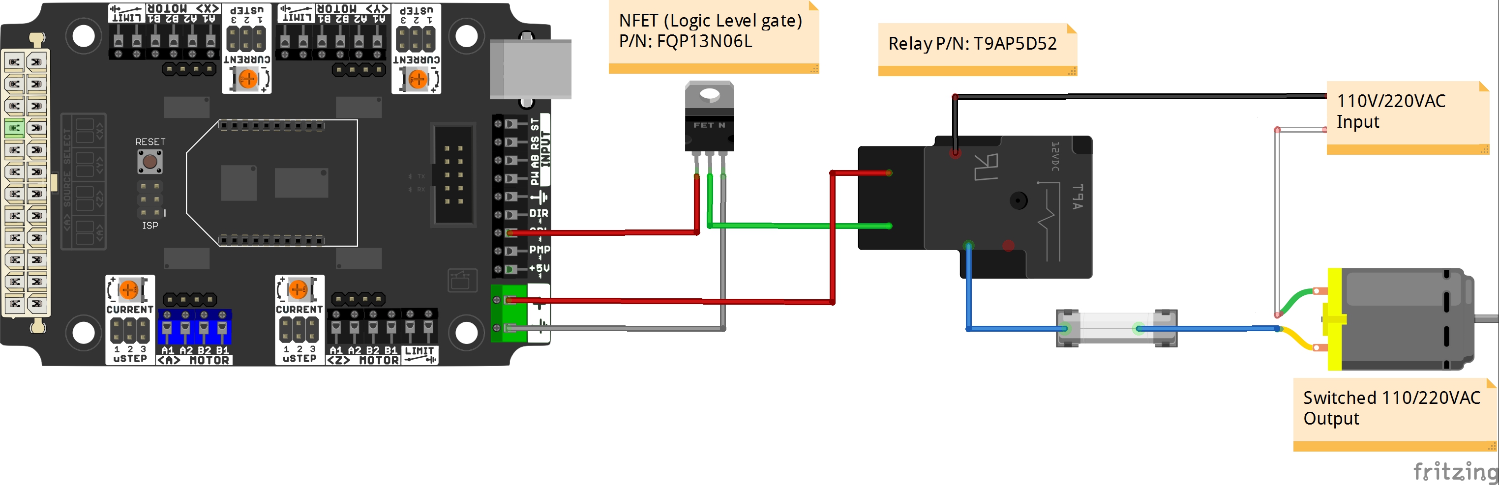

    I'm having a problem trying to set up the SPL output pin to control my spindle. I have it connected exactly as shown in the drawing below, but sending M3 doesn't start the spindle. I checked the voltage between SPL and GND and I'm reading about 0.2V where it should be 5V. Do I have a bad board or am I missing something?
  28. John Meikrantz
    John Meikrantz Well-Known
    Nov 2, 2014
    169
    56
    What version of GRBL are you running?
  29. Jake Fry
    Jake Fry New
    Dec 3, 2014
    18
    I'm using GRBL 0.9i
  30. John Meikrantz
    Nov 2, 2014
    169
    56
    I think in 0.9i, instead of enable it uses PWM output, from 0-5v. You might need to send M3 with speed to increase the voltage? What happens if you send M3 S1000? (Max speed, should be 5v).
