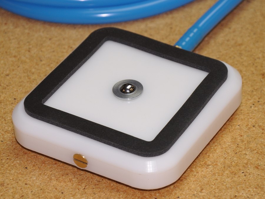

    I saw a really neat system for woodworking where the guy made a flat puck out of plastic with a gasket on each side. In the center of the puck was one of these recessed into a hole:
    It's called a bullet catch, and it's used on cabinet doors to hold them closed. There's a little spring inside that holds the ball against the end of the barrel. These guys were using them as valves. The back side of the catch opened up on a chamber that was under vacuum. The vacuum wasn't enough to pull the ball back against the spring, but if you put something flat down on top of the catch, and pressed down, the ball would get pressed down and allow vacuum into the chamber formed by the gasket. The vacuum was then enough to hold the piece in place. The vacuum was also applied on the back side of the puck to stick it to your workbench, and several pucks could be coupled together with a hose. The larger the work piece, the more of these little pucks you could use to hold it down, and the greater the holding force.
    You could also make a larger version of this with small gasketed "cells" that would each have their own valve. This way you could stick down almost any size work piece just by covering up the cells.
    Problem comes when you have to machine through holes...
