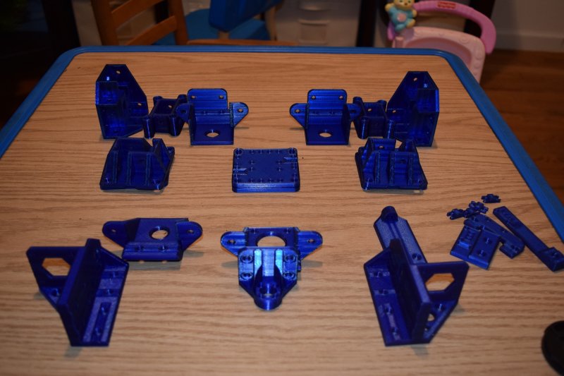

    Thanks for splitting and adding the LED groove, I am printing them now. I am printing in PETG from eSun, nice filament. makes strong flat parts.
    I didn't see any stl's for the bracket that holds the acme nut. I think that's it. Hopefully they get some more stock of 20x20 in black.
    I am just waiting to get all the parts printed, BOM is finalized. 12"x12"x20" should be the final volume. Going with a mightyboard, only because thats what i know, going to mount dual direct extruders, parallel to the gantry bar, on a custom wide aluminum cooling bar.

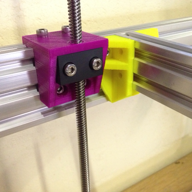

    http://openbuildspartstore.com/8mm-lead-acme-nut-block/
    Yes, I think if you mount it rotated 90 degrees it will be fine. The only issue is that you will need a spacer(s) to move it off the extrusion to align with the motor shaft. I haven't designed one as I didn't use this part, but you should be able to get away with a non-printed spacer until the printer is up and running. Nominally a nema 17 is 21mm from the side to the shaft centre. This block 6mm to center, so you will need to space it 15mm off the extrusion.
    http://openbuildspartstore.com/threaded-rod-plate/
    This will also work for you. Keep in mind that this plate is aluminum and not plastic, M5 bolts are pretty beefy, the cantilevered distance is small, and that you will have 3 support locations.

    Here is the nut catch I used. It was specifically designed to fit the lead screw nuts I had from ebay and since there are cheaper sources available now, I didn't recommend them to others.

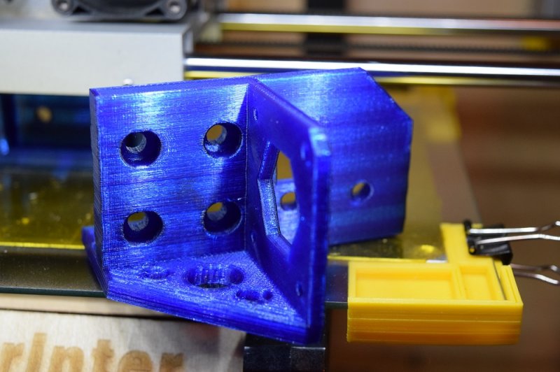

  17. adamcooks
    adamcooks Well-Known
    Nov 6, 2014
    244
    65

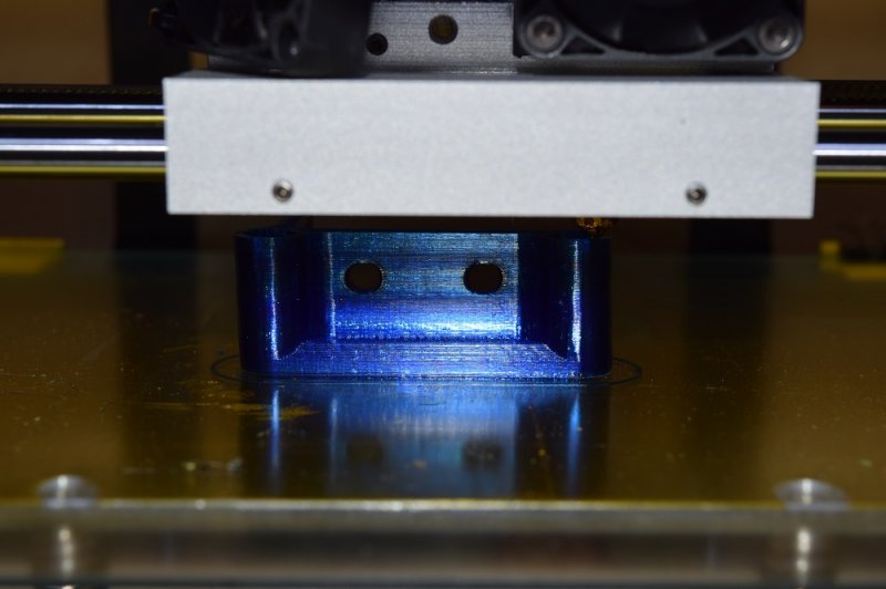

    started to print the gantry slider this morning. It looks like the clamps for the extruder are slightly elevated from the slide pieces. should be interesting to see how this prints.
  18. adamcooks
    Nov 6, 2014
    244
    65
    I just separated the bowden mount from the gantry plates. If you need them your slicer will put them on the plate. I have yet to print them, but the toolpath looks correct in S3D
  19. Carl Feniak
    Carl Feniak Journeyman
    Mar 18, 2014
    654
    246
    Yeah, sorry. You are not the first to have this issue so I should just fix it. If you use the split objects option in slic3r then it will drop all the objects to the build plate.

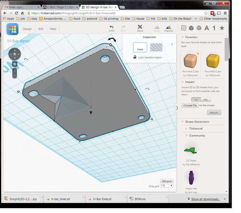

  20. NickM
    NickM New
    Nov 13, 2014
    30
    MichaelS likes this.
  21. NickM
    NickM New
    Nov 13, 2014
    30
    Oh, and here's a picture of it.
    Balu, Guilhaume, DiggerJ and 3 others like this.
  22. Carl Feniak
    Mar 18, 2014
    654
    246
    Looks solid, mind if I add a copy to the files page of this build?
  23. NickM
    NickM New
    Nov 13, 2014
    30
    Please feel free to add it to the files.

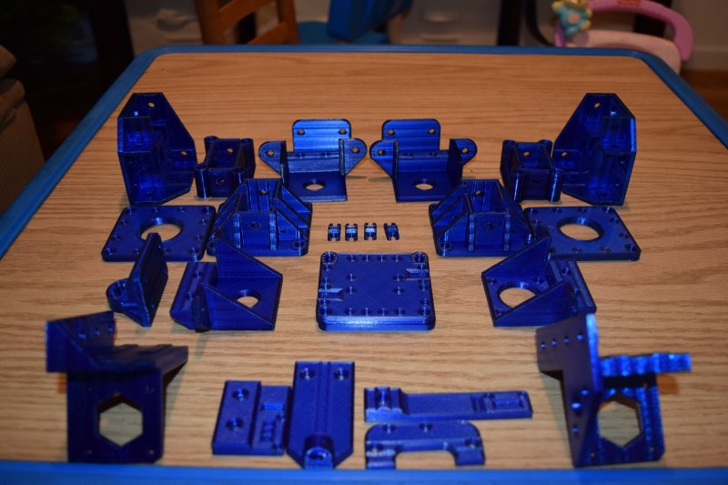

  24. adamcooks
    Nov 6, 2014
    244
    65

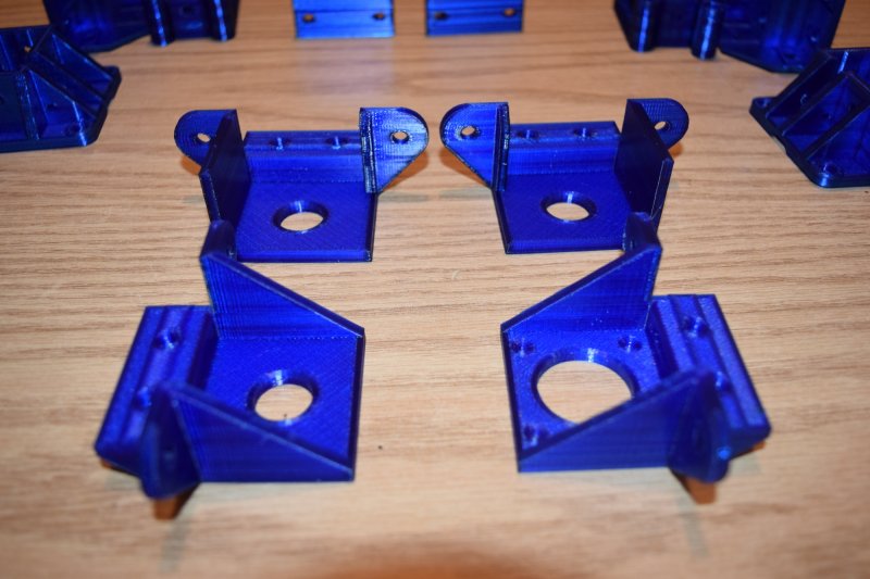

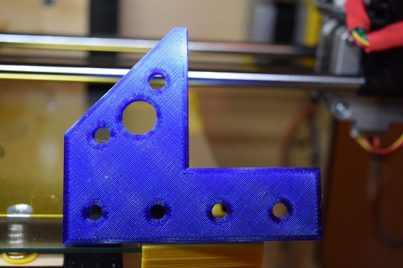

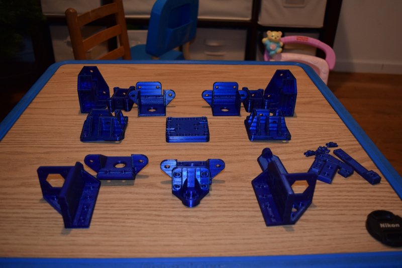

    I have got to take a pic of all the parts printed. That blue PETG looks beautiful. My UPS man will love me later this week while he delivers 11M of vrail.
  25. adamcooks
    Nov 6, 2014
    244
    65
    sorry for the poor lighting DSC_0209.JPG DSC_0213.JPG DSC_0218.JPG DSC_0219.JPG
    DiggerJ and Carl Feniak like this.
