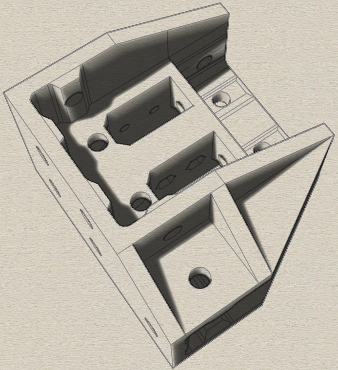

    @Carl Feniak looking at the XYIdlers and the XY Motor Mounts you have a 10mm hex on the outside of the rail housing. What purpose does this serve?
  7. JCPhlux
    JCPhlux Well-Known
    Apr 19, 2014
    209
    48
    My first question was about the blue circles.
    What is the part in red for?

    The blue circled hex holes serve no purpose, they are just holes so that less plastic is used during printing.
    The red ones are for bolts to the V-slot extrusion end holes, which I drilled out to 4.5mm before assembly. The hole is countersunk so the same hex head M5x10mm bolts used elsewhere will work.
    If you don't have a 4.5mm drill bit, a 3/16" might work but leave less material to bite.

    I have a m5 tap
  10. JCPhlux
    JCPhlux Well-Known
    Apr 19, 2014
    209
    48
    Is there that much of a savings? Do you thing it weakens the structure at all?
    Why do you not just print the hole?

    You're right, there really isn't much of a savings in plastic. It really isn't a critical stress area so I don't think there are any structural issues with these. Easy to remove though once I finally post the 123D files. ;)
    As for the red holes above, they are fully printed in the idlers. There is a 0.2mm membrane layer designed in to facilitate bridging over the countersunk hole, but otherwise no drilling needed. The hole that needs to be drilled/tapped is in the end of the aluminum extrusion itself. They are about 4mm when you get the V-slot and needs to be enlarged to fit a M5 bolt. It can be tapped to M5 size or if drilled close enough, the bolt can cut threads for itself.

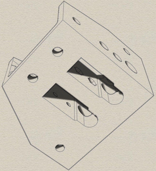

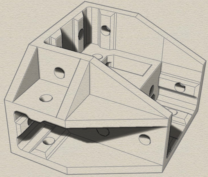

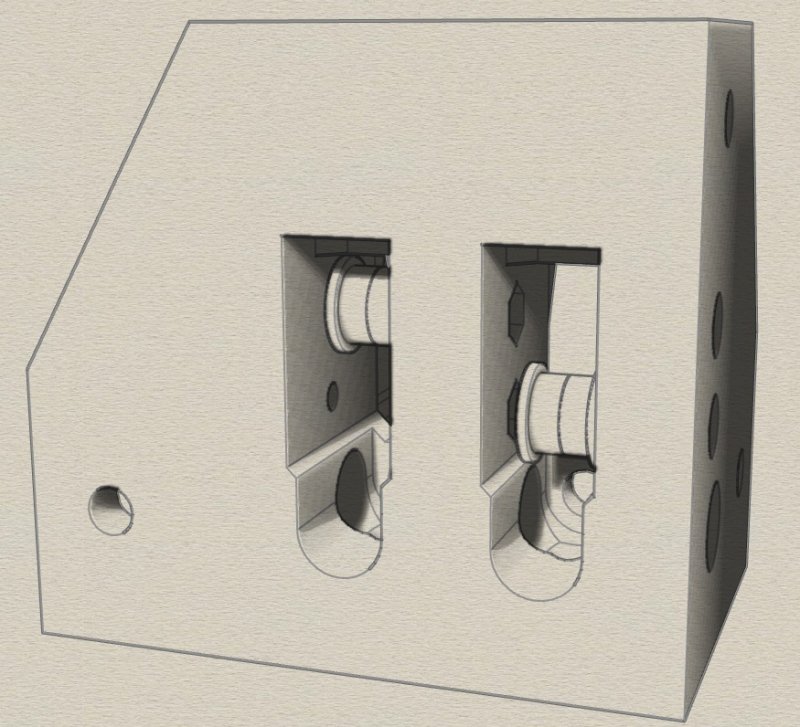

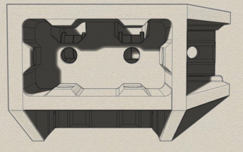

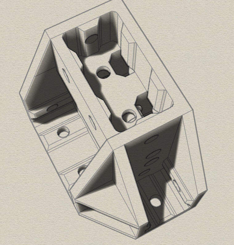

    So here is my re-imagining of the XY Idlers.
    I have made the holes more generic so that the left and right are exact mirrors.

    Looks good. I see you are going with a 20x20 on the vertical legs. I think this a good modification to enable the use of a two plate setup for the Z axis.
    I don't think the bolt holes you added where the hexagons once were will be usable as the belt needs to run through that section of extrusion. However, I think your version is printed most easily from the left hand side of your first picture being down on the bed, which would enable you to add a support on the inside of the extrusion if you wanted.

    Yeah the 20x20 felt like a good fit.
    I am planning on changing the back plate also I am going to play with the spots that have overhand and see if I can add a taper instead of corner so I don't have to worry about support. I will post the STL file once I finish so you can see all the inter changes. It is hard to see in the images.

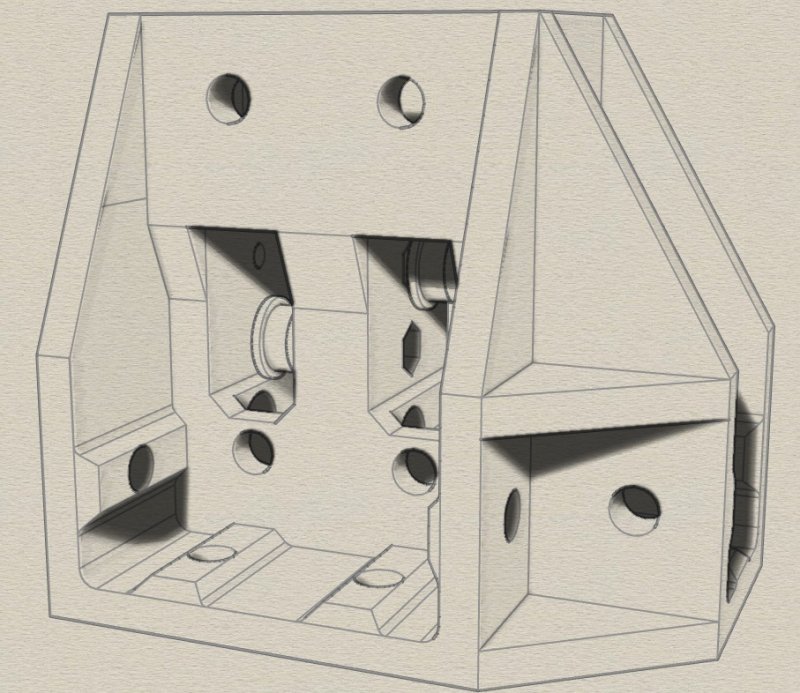

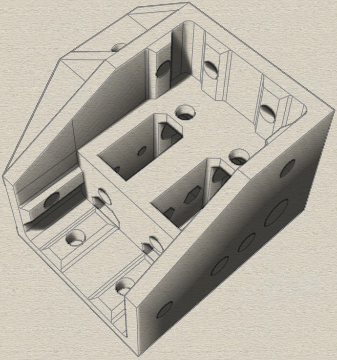

    Here is the STL file for the corrected version and some more screen shots. I am a little worried about some of the overhangs still. Any suggestions would be great.

    Excellent mod. You said you were using sketch up for them?
    Two things to note:
    -V-Slot has pretty sharp corners. You are going to have to greatly reduce or remove the corner rounds from the inner extrusion profiles.
    -regarding the second support web for the 20x20 extrusion, do you think it will bridge at an angle? I guess it depends on the intelligence of your slicing program!

    I am using Rhino 3d.
    Here is a shot of it with extrusion.

    I redesigned the XYIdler. I think I have addressed most of the issues.
