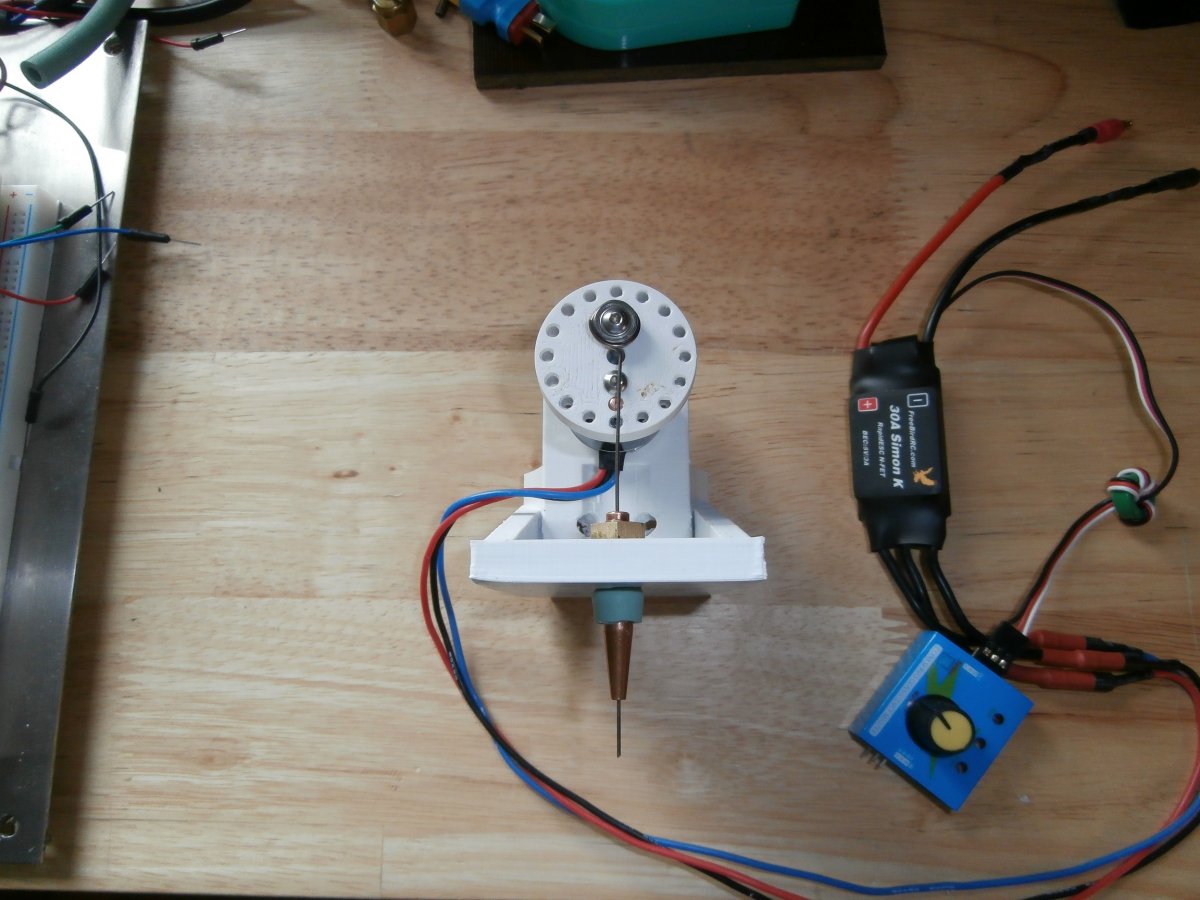

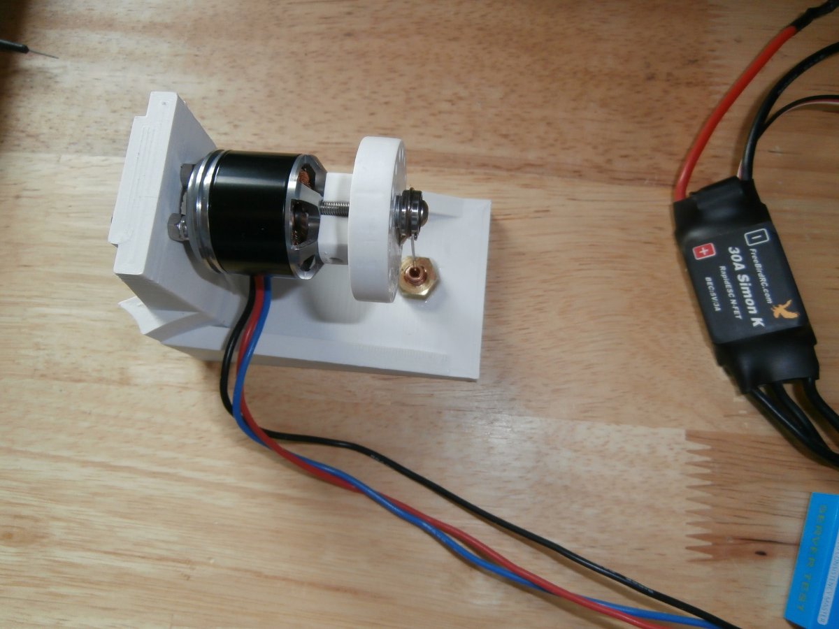

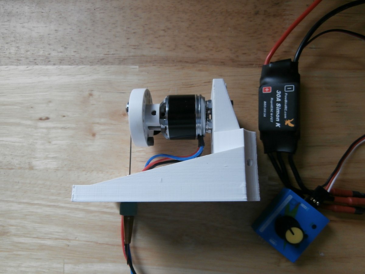

    It has been suggested to me that the RC'ers here on Openbuilds might be interested in my Brushed/Brushless Motor Foam Cutter. The method is "novel/unique" but not new... I've been using it for several years now to cut all kinds of planes and figures out of various sheet foams (bluecor, DTF, etc). I actually introduced this back on the Phlatforum (http://www.phlatforum.com/xenforo/threads/perforator-style-foam-cutting-head.2836/) in the summer of 2012 as a possible attachment for the Phlatprinter Mk3 -- Mark even thought it was neat! -- but sadly it never gained tracion or much notice.
    But recently it has undergone further development/refinement on my thread over on the RCPowers forum (Mostly Printed CNC and cutting foam) and been adapted to Ryan "allted" Zellars' Mostly Printed CNC (Mostly Printed CNC / MultiTool by Allted). This is a very flexible and affordable CNC machine in its own right... I've built 3 of then over the past 2 months for myself and a couple of friends. The foam cutter attachment itself however is simple/cheap, relatively easy to build (3d printed parts are NOT necessary), and easily adapted to virtually any CNC machine.
    I have published a couple of versions the CNC foam cutter attachment on Thingiverse. There is a brushed DC motor version (MPCNC foam-cutter attachment by dkj4linux) and an 2826/2822 brushless motor version (MPCNC 2826 Brushless RC Motor Foam Cutter by dkj4linux). It is absolutely perfect for cutting sheet foams for RC aircraft parts. I've been using this method for several years now to machine-cut my planes out of fanfold foam insulation sheet and DollarTree foamboard. And though it appears crude I have cleanly cut many sheets of foam using this method with minimal fuss.
    Basically, it's a very fast reciprocating needle... like a sewing machine. The needle is formed from a length of 0.025" music-wire and attached to a small ball-bearing mounted eccentrically on the flywheel. The flywheel is mounted on the shaft of a 2826 brushless motor (with ESC and servo tester) and spun at 8000-10000 rpm, resulting in a stroke/perforation per revolution. A feed rate of 600-1000 mm/min yields 10-15 strokes/mm and cleanly cuts DollarTree foam board (paper on), blue-cor fanfold foam, etc.
    WRT the tool chain I use, I most often convert PDF plans (or whatever) to DXF and import into SketchUp, scale/edit/arrange the parts into one or more sheets, and then use the SketchUCAM plugins to generate gcode. Straight-pin a sheet of foam board onto the bed of the CNC, load the plane/figure gcode, set the origin, and let it rip. Twenty minutes or so later you have a sheet of parts that are accurately cut, easily punched/pressed out, and hot-glued together.
    Please take a look. I'll offer information and support to help as best I can if you decide to give it a try.
    20151225_092148.jpg 20151224_124214.jpg 20151220_132533.jpg 20151219_131718.jpg 20151219_131801.jpg 20151219_134157.jpg 20151219_134218.jpg 20140930_004639.jpg 20151116_235705.jpg

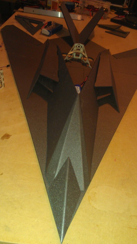

    Only place I've seen this type of cutting was at a place that cuts custom gaskets. Never really thought about it as a good foam cutter. Fantastic share!
    Plane looks good too, pretty sure I bought one of those as one of my first foamies.

    Thanks! My inspiration came from engineer/artist Tom McGuire who made AFAICT several dedicated foam cutting machines...
    I simply took his idea and adapted it to a conventional 3-axis CNC machine... first, for a couple of BuildYourCNC machines I built several years ago and, most recently, the Allted's Mostly Printed CNC. The plane in the pictures and video is an RCPowers F117 v3. I've always loved his score and fold build method -- the first nearly-five minutes of the video in my first post are all the 50% depth score cuts, the rest is the full-depth outline cut for the central fuselage. I've bought/built most of his V3 and V4 plane packages and they are not only impressive to look at but also perfect for cutting with this foam cutter. That's also why my thread is over on the RCPowers forum. I'm still astounded that so many accomplished RC builders are still hand-cutting their planes... but then again relatively few have a CNC machine. I doubt that's the case here on the Openbuilds forum... :)

    Speaking of power... I'm turning 8000 rpm or so (enough for nice cuts at 600 mm/min) on the 2826 brushless motor, drawing just 1.25-1.3 amp at 7.4 volts. Rather than the 10's of amps these components often see while flying they're loafing along at only 10 watts or so. I'd bet a BW 1300kv would do the job nicely as well. -- David

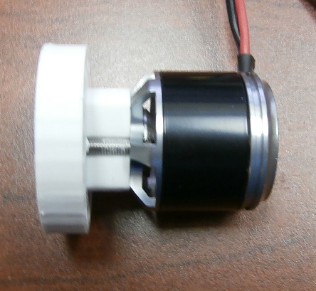

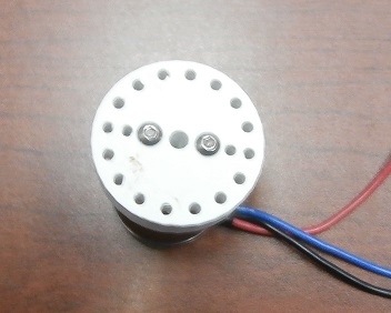

    Well I am very happy with the flywheel. I enlarged the center hole to 4mm to match up with the 3DR closeout Iris+ motor shaft (unbranded T-Motors for $3 each) and the two flywheel holes just outside center were drilled out to 3mm. They were the perfect distance apart for direct mounting to the motor's existing flush mount prop holes with 3mm X 20mm long button head screws. Now off to look for a bearing and other parts. ;)
    Thurmond

    I did run it up to full speed as is with a 3S LIPO and I was able to hold it with 3 fingernails clamped to the base so the flywheel balance is pretty good till I add the bearing. Yes I plan to countersink and I have a very high speed bearing from a hard drive I will try. If it doesn't work out since I may be one of the worlds largest pack rats (18 years in Semiconductor fabrication has blessed me with many technical cast off items) I have lots of bearings. I will use a prop balancer for static balance and a laser for dynamic (if necessary). I did not get a chance to print the mount yet. I have some nice titanium tig filler wire for a needle. More to come.

    Sam, I'm not sure about the scraping action you mention... there is virtually no debris generated if the needle is pointed properly. That's certainly the case in all the foams I've tried... blue-cor FFF, styrofoam, and DTF. I try to get a short, conical point on the needle... much like a sharpened pencil... and symmetrical so that the cutting action is the same regardless of direction of travel. I plan to give the 9mm EPP a try but I'll need to take care to get the needle length right... there's only 12 mm of total needle travel with the current flywheel. I'd like it to barely retract into the body of the guide, leaving only 10-11 mm exposed. I'm thinking the rounded head of my carriage bolt needle guide might actually be something that makes the hold-downs simpler... much like the needle foot on a sewing machine (flexible material lightly pressed down under the foot).
    I've never had bearing issues in the motors... I did have a bearing go out on the flywheel though. I replaced it with a bearing out of a junker motor. The outer race needs to be lightly grooved to help retain the needle loop. -- David

    No melting (unless you go too slow feed and/or too high cutter rate) of the foam, the needle does "compress" the foam to a degree... but not much. It's much like (I shudder to think about it!) the thin, sharp-pointed, rapier blade being run through soft belly flesh; i.e. innards offer little resistance and get pierced and/or pushed aside very rapidly/easily. Yuck! Last time I'll use that analogy...
    Tom McGuire's machine IIRC was a dedicated foam cutter that didn't implement a real Z-axis... so it had to stop the needle at the top of its travel before moving to the next cut. He used HPGL (no gcode) and somehow reversed the polarity of the motor voltage when he needed to pick up the needle... that then engaged a solenoid-operated catch-arm that swung over and caught the head of the set-screw as the flywheel backed up to the upper-most position. It was quite clever and obviously worked well but I think he said it was very fiddly to initially get set up and aligned. It's far simpler when you have a fully-implemented Z-axis like we have... just let it run all the time and then pick up the whole mechanism when it's time to move to the next location.
    I love the idea of angle cutters though I'm not sure how the Z-axis movement and plunging to depth would work... I had thought of side-by-side and/or gradually-deepening passes "chewing" the foam to make a chamfer/channel but never pursued it. -- David

    No X-Mount as they were for the Iris+ which did not use them. The Black prop adapter uses the standard right hand thread nut.
    The package contains the motor, the prop adapter (total length of adapter shaft is just under 12mm and too short for most prop hubs and a locking nut) and two 3mm cap head Allan bolts to hold on the adapter. No prop nut is included because the Iris used spin on props. 16" motor leads and the leads are glued where they enter the motor housing. The motor is perfect for the 3 hole direct mount hubless CF props if desired for flight.

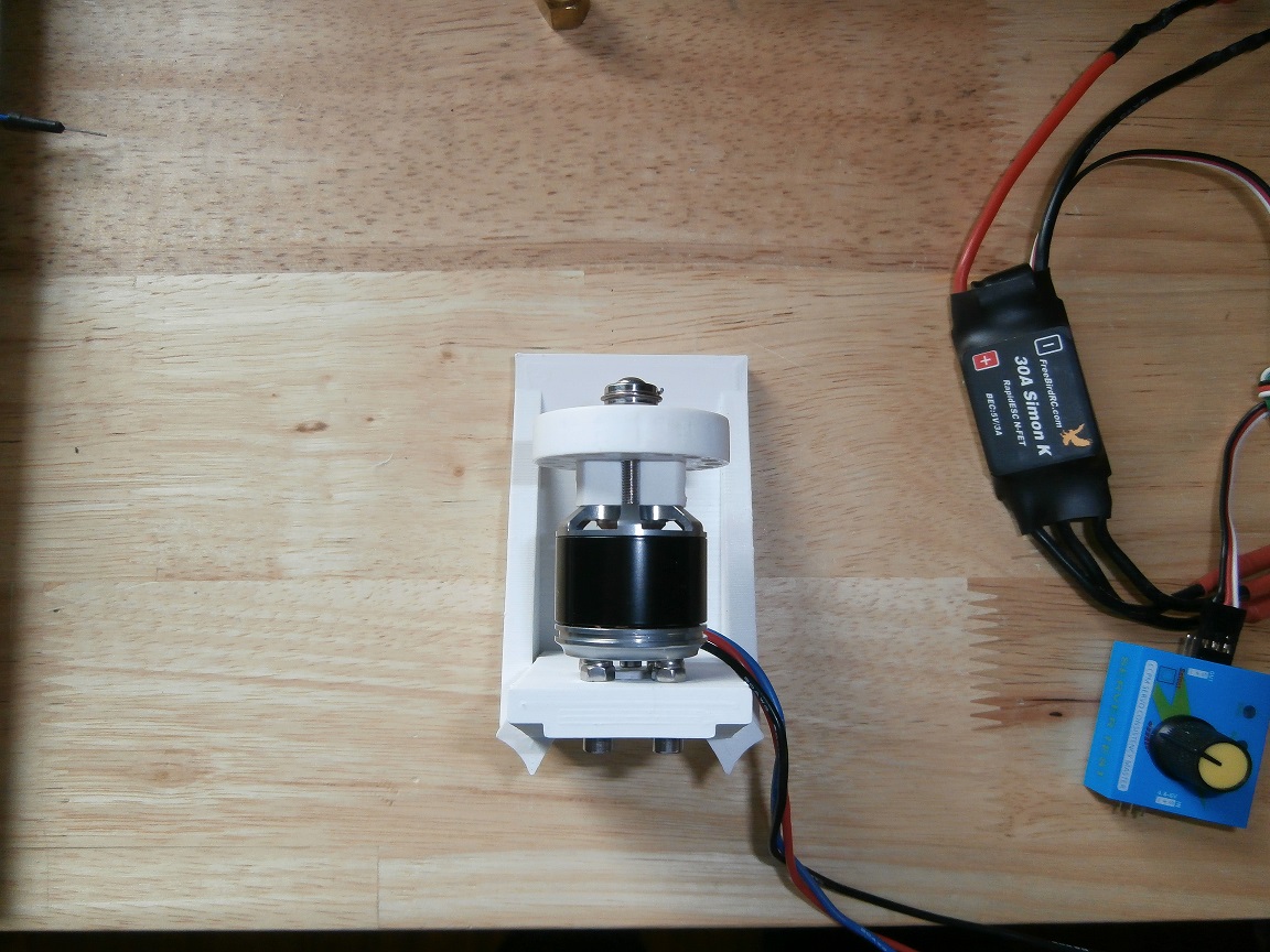

    Well mounting a bearing was as simple as removing one of the button heads and replacing it with one 5mm longer. Two 3mm washers were placed under the bearing. I still have to groove the bearing a bit deeper. This puts my bearing in the same place as David illustrated above but without any of the hardware to tighten it to the shaft since it is bolted directly to the motor bell. More to come.

    OK sorry I was not around yesterday. Here is a modification I made pictured below. I used some .030 mig wire I had around for Skew Planar Antennas and since it is MIG wire I did the logical thing and used a MIG gun tip for the needle guide. It was a Tweco® Model 14T-30 .030. Balance was achieved with one 3mm X 6mm black cap head socket screw from the back side of the flywheel and 1 small slug of copper wire in the next hole in from the perimeter (see pictures). I plan to do a better mount for the needle guide. The threads are 1/4"-28 UNF-2A. My needle guide is glued in for now since I was improvising when I came up with it. The needle guide needs to be lower in my next iteration.

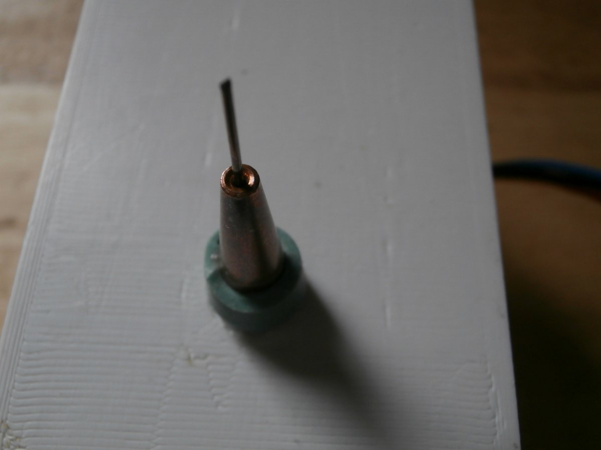

    Outstanding, Thurmond. I actually used 0.025" MIG-wire for my first versions. I'm not a welder so really didn't know about the tips that are available. They look PERFECT for what we are doing... and far easier than boring out a carriage bolt! I'm anxious to see it running. I wonder if Lowes carries the tips... that's where I got the spool of wire. I'm gonna go check as soon as I finish this post.
    You may know this already... but did you know that you can straighten and work-harden/stiffen MIG wire by twisting it? I use my Dewalt hand drill and a drill-press vice... take a couple of feet of wire, pinch/hold one end in the vice, attach the other end to the drill chuck, stand on the chuck while gently stretching the wire and start twisting it with the drill motor. You've gone far enough when it breaks. The wire is then perfectly straight/stiff and almost perfect for forming needles for the foam cutter... or push-rods for your RC aircraft.

    Oh, happy day! Lowes had MIG tips... 0.035" (0.9mm) card of 10 tips for less than $7! They ought to be perfect. I've got to print Karl's quick-change version of my foam cutter yet so I think I'll build it up using one of these tips. What a great tip (pun intended!), Thurmond! -- David

    I was wondering if the .035 tip would work well with .032 wire (can be had at most local hobby stores). You will have it thoughly tested very soon. Been wondering if a hardened nozzle for a 3D printer would do well, and last longer.
