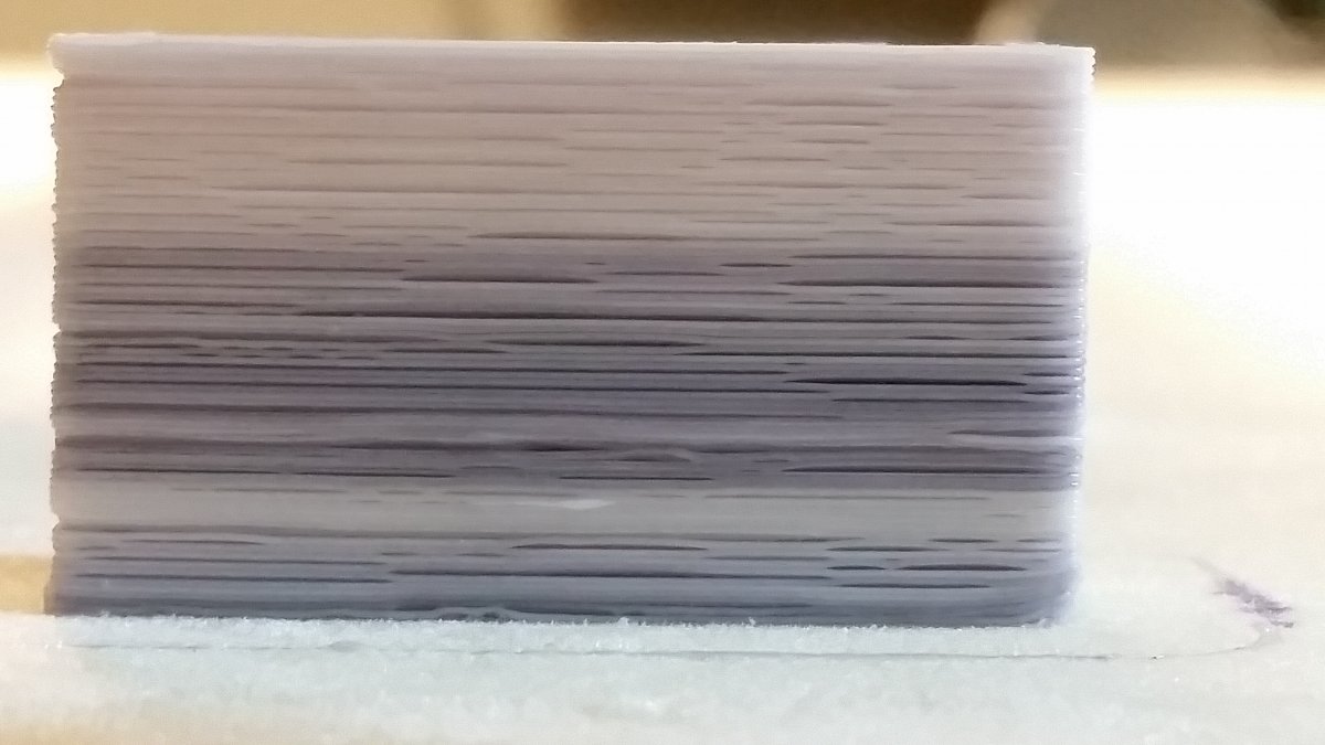

    regarding the printed part, have the same delamination on my first successful print.
    nozzle was 0.35 mm, and filamwnt was pla 1.75 mm.
    temperature was 185 c.
    did you guys figure out why it happens?

    Player should be printed around 210 c. 185c is causing your problem

    will try 210 c.
    thank you, sir.

    Your filament feed may be too low as well. Try bumping it up a bit.

    Val, I should have asked first, but have you calibrated your extruder? If not there are lots of good youtube instructions that can walk you through the process. It's not hard, but more involved than I can describe here in a couple paragraphs.

    this here pic is taken after the printing of the delaminated part. one can see it under the extruder.
    ..and below is the second attempt, with 210 celsius temperature per steve's recommendations. part printed fine, it's just that i forgot to add support for an overhang. it printed it anyways..:)
