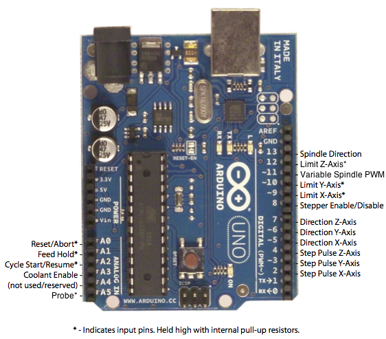

  19. m-Kresol
    m-Kresol New
    Sep 18, 2017
    Hey guys,
    first post with a problem ;) I have no experience with Arduinos or programming and am looking for some help.
    I recently aquired a EleksLaser A3 with a 2.5W diode laser and a ManaSE controler. I am trying to use it with grbl1.1f + universal g-code sender on my mac. I have no problems flashing the arduino or connecting to it. I can also operate the x and y motors without problems. However, I cannot control the laser at all. It comes to live very short when connecting to the arduino, but nothing after that.
    I switched to laser mode and altered the x/y acceleration. I left everything else as is.
    I tried the following:
    measuring voltages: M03/M04 changes D13 high and low, but D11 is always LOW (independent of spindle speed setting with S... command. I tried everything from S0 to S1000, although max speed is defined at 255). I also didn't measure any PWM modulation with my cheap scope. tried to enable "use_spindle_dir_as_spindle_enable", but without success (was a long shot and not really knowing why I tried). I disengaged "define variable_spindle" and m03/m04 changed D13 as well as pulling D12 high! The laser however is wired to D11, so this was more for confimation of my sanity than anything else.
    I also tried the following code:
    Code:
    int ledPin = 11;                 // LED connected to digital pin 11
    void setup()
      pinMode(ledPin, OUTPUT);      // sets the digital pin as output
    void loop()
      digitalWrite(ledPin, HIGH);   // sets the LED on
      delay(2000);                  // waits for 2 seconds
      digitalWrite(ledPin, LOW);    // sets the LED off
      delay(5000);                  // waits for 5 seconds
    this toogles the laser ON and OFF as advertised, so I know the laser works properly. I'm led to believe that there is a bug somewhere hidden in the code concerning the definition of D11 as PWM and enable output pin. No idea how to find and more importantly recognize the problem, so I was hoping for your help.
    EDIT: Read some stuff about a jumper underneath the arduino. The jumper is not connected. Please let me know, if this is correct.
    let me know, if you need any further information. Thanks for looking!
    cheers,
    Felix
    #649 m-Kresol, Sep 18, 2017
  20. phil from seattle
    phil from seattle Journeyman
    Mar 17, 2017
    312
    137
    I'm traveling so can't check but you need to have the correct config of grbl. What version do you have? Also, read the grbl config.h. even if you aren't a programmer it will give a lot of info.
  21. David the swarfer
    3,277
    1,834
    maybe these guys can help you (the actual Mana SE forum :)
    EleksMana SE
  22. m-Kresol
    m-Kresol New
    Sep 18, 2017
    I tried that forum (and benboxlaser.us actually) too, but haven't had any luck. The general thing to do is to just buy a windows computer or run bootcamp, but I would prefer not to spend more money.
    Thanks for your reply. I'll check the config.h more closely. Just had a quick look at it. I use grbl 1.1f.

    I finally got it working!
    So, I tried several things, but nothing was doing the trick: D11 (engaging and PWM pin for the laser) was always low, but I could toggle it on and off with a simple line of code. Thus, I knew that there was only a software bug hidden somewhere in the grbl code.
    Zax (the guy that developed T2Laser) indirectly led me to the solution. He mentioned that I should use M03 command to turn the laser on and S... to adjust the power. In grbl it's up to 255 and in the elekslaser firmware up to 1000. So, I thought I should give the elekslaser firmware another go (when I tried it, I wasn't aware of the M03 command). After flashing the arduino and typing M 0 3 S 1 0 0 0 very slowly to build up tension, the laser came to life. Oh, what bliss! Now I just hope my fire alarm doesn't go off ;)
    So the trick is to use the elekslaser firmware (basically an altered version of grbl 0.9i. I was trying to use 1.1f since it has a specific laser mode) and then you can use the universal gcode sender. if anyone on mac/linux is wondering. the code to flash the .hex to the arduino is:
    Code:
    /Applications/Arduino.app/Contents/Java/hardware/tools/avr/bin/avrdude -C/Applications/Arduino.app/Contents/Java/hardware/tools/avr/etc/avrdude.conf -v -patmega328p -carduino -P/dev/cu.wchusbserial1410 -b57600 -D -Uflash:w:/Applications/ManaSE_v3.7.hex:i
    MAKE SURE TO ADJUST THE FILE PATHS!
    Another thing, which is already included in the ManaSE firmware: the steps/mm for x and y axis is 80!
    Now I just need to find a good way to generate gcode from png picture files. I usually use gimp to design my graphics. there are plugins for inkscape, but the one I used for trials only does outline, but I need full area too. any recommendations?
    Also, if anyone knows where the bug in the grbl 1.1f is, I'd be happy for any advice. The manaSE firmware is supplied as a hex, so no way to find out the differences.

    Hi, I think I'm finally in the correct medium to be asking my questions: My GRBL controlled machine is 2.5 Axis, Z axis home calibration is disabled.
    Manual jogging of the machine works with $20,21,22,23 etc all switched off
    ($5 = 0), and using pull up resistors with Normally Open switches. LIM Function reports the switches to be working properly.
    Homing sequence issue as per github:
    The Sequence s:
    X and Y axis
    X, Y Axis move both to Homing direction at fast rate ($25)
    The first Axis triggers the switch will stop and wait for the second axis to trigger
    When second axis triggers the switch, both axis back off a distance ($27)
    Both X and Y axis will move toward switches again slowly, until both switches triggered again ($24)
    Both X and Y axis will back off a small distance ($27)
    My machine after pressing $H the machine just moves the distance $27 on both X and Y once.
    This means the program is not processing the homing sequence because it is meant to perform the triggering twice per axis if it assumes it is seeing the home button (High speed movement to trigger the axis, then the low speed movement to perform precise homing)
    Possibility 1 Limit switches button is constantly triggered throughout the whole process, hence doesn't feel the need to perform the re-trigger.........even though the feedback I get from the LIM function which is reporting back all 4 switches work correctly for X and Y axis only trigger when pressed. ($5 = 0), and using pull up resistors with Normally Open switches.
