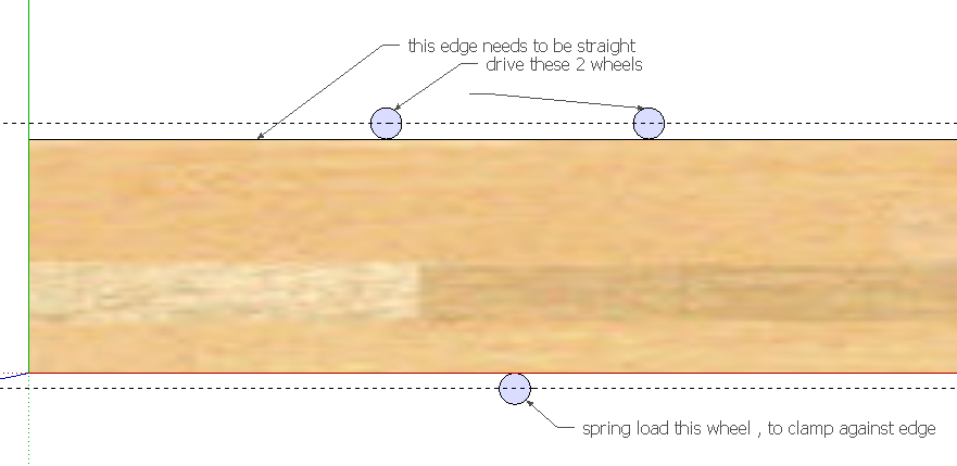

    how about using the workpiece as the Y axis?
    so if the base is made as a triangle, drive 2 wheels on a flat edge, and spring load a wheel on the other side (which does not have to be perfectly straight).

    You mean have the 'OX' ride the edge instead of pulling the workpiece through ?
    It certainly would make sense to work large / heavy pieces which have at least one true edge and the other relatively parallel ... within spring loaded wheel's capacity to compensate any variations. The force needed would be consistent no matter the size of the workpiece since the tool would be moving (constant weight).
    Could have a set of wheels on either side of gantry to ride the surfaces of the workpiece. Top wheel fixed to keep working side parallel withi tool end, bottom wheels spring loaeded to allow enough friction to hold work piece and ride it along with side wheels ...
    The drive wheels could be somewhat spiked to bite just enough into the workpiece .. They are not making contact with areas of the workpiece being kept once work is done. Regardless, workpiece will need to have minimal thickness - the width of wheels riding the edge ....
